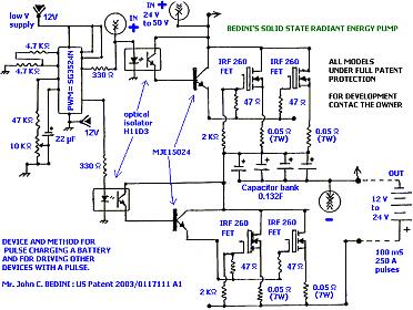

Hi Guys
Attached a schematic from a JB patent that I want to build, has any one here built this and what was the out come?

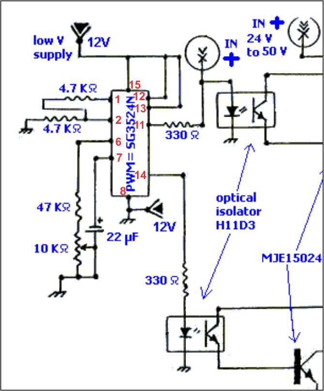

Also can anyone please help me with the pin numbers on the PWM - SG3524N chip for the corresponding connections to the chip as shown, (before I start making a PC-board.)
I think I have some of the pins right, if someone can please confirm it for me.
Also must some of the other pins not used be tied to ground or positive rail.
