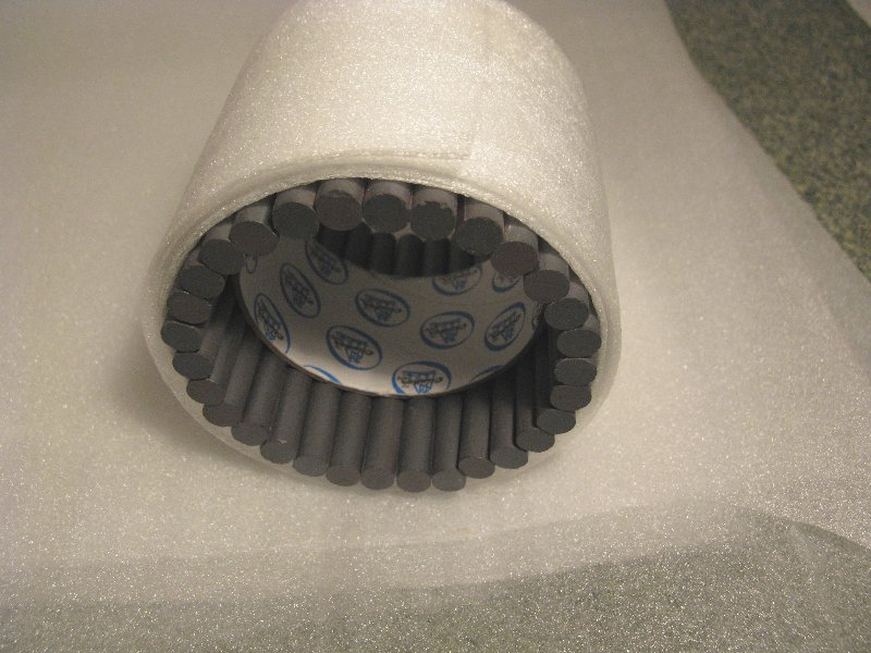

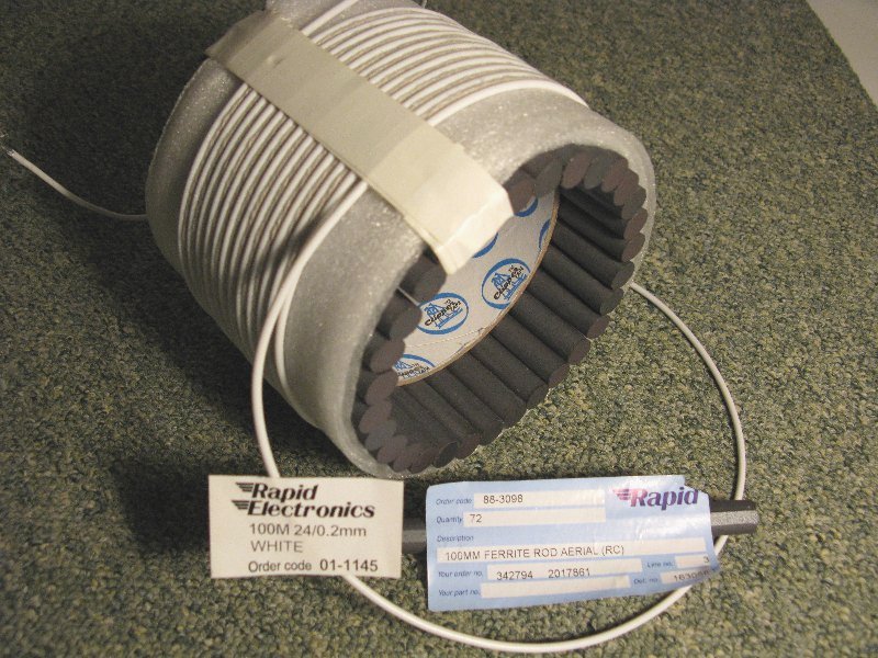

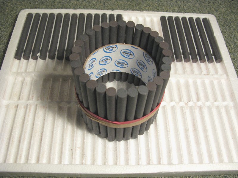

      This was a SW FS Loop antenna for 1.7 to 6.2MHz.
      The cardboard former is from inside a roll of parcel tape.
      Rods are 100mm x 10mm dia standard MW/LW AM types.
      Parcel foam insulation (essential) is about 1/4" or 5 to 6mm thick.
      The tuning range is dependent upon your variable capacitor.
      The 24x 0.2 wire is string or strimmer line spaced. Use 16x 0.2 for MW.
      Gary used Litz wire, but not essential if turns spaced.
      Aim to space winding turns out over 70 to 80% of rod length.
      Overall about 4" long and 4" dia, but like having an outdoor wire with ATU !
      Note - still directional at 6.2MHz so can null stations, interference or TVs and switch mode PSUs etc.
      To connect to a SW portable merely connect one end of the coil with a croc lead to the collapsed whip antenna.
      The coil couples resonantly with respect to its own self impedance reactance in surrounding free space !
