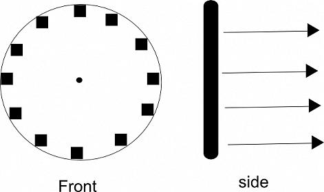

Thanks for the suggestions Ufo, that could certainly make the gluing easier.
I had all the magnets polarities facing towards the front, see diagram:

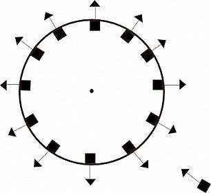

I was going to next try, turning them all to face outwards to the side, rather than to the front as they are now.
Thanks,
wonza
Thanks,
wonza
Your rotor has much more of a chance of being truly centered
