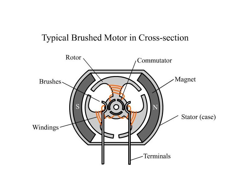

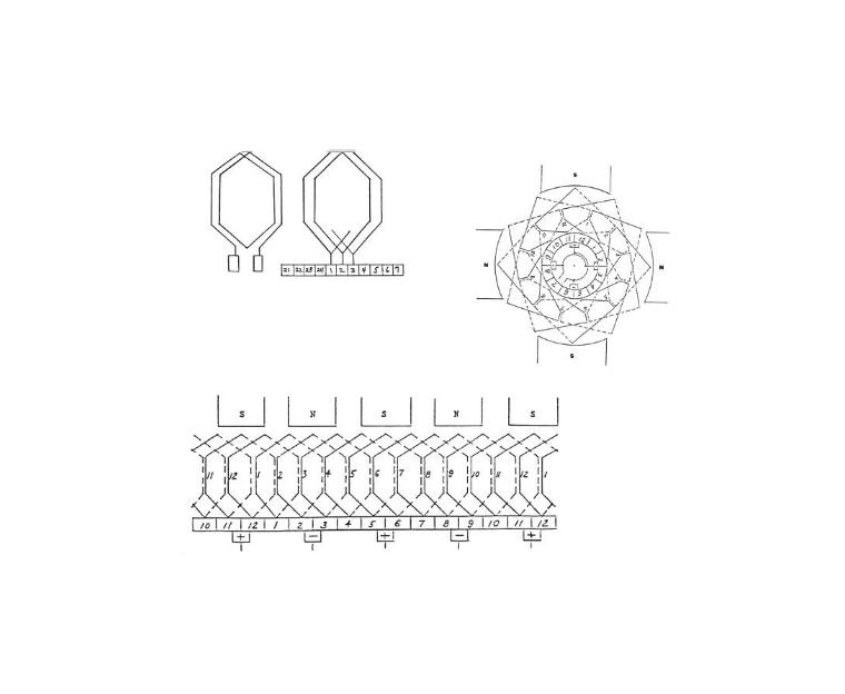

                                Look, your left drawing it's from text-book for understanding of principle how DC CM motor work;
                                In fact, motors windings made in different way, depending of application, much more efficient (most popular are a wave-, lap-windings);
                                Here's some in attachment;
                                Notice the ALL poles in action at the same time, no reverse drag; 80-90% efficiency.
                                The same is in Alexanders patent, from which you just extended the loop.
                                But yours is worse (sorry), cuz there's only one pair coil at the work;
                                BTW if you have speed, you do not have torque and vice-versa.
