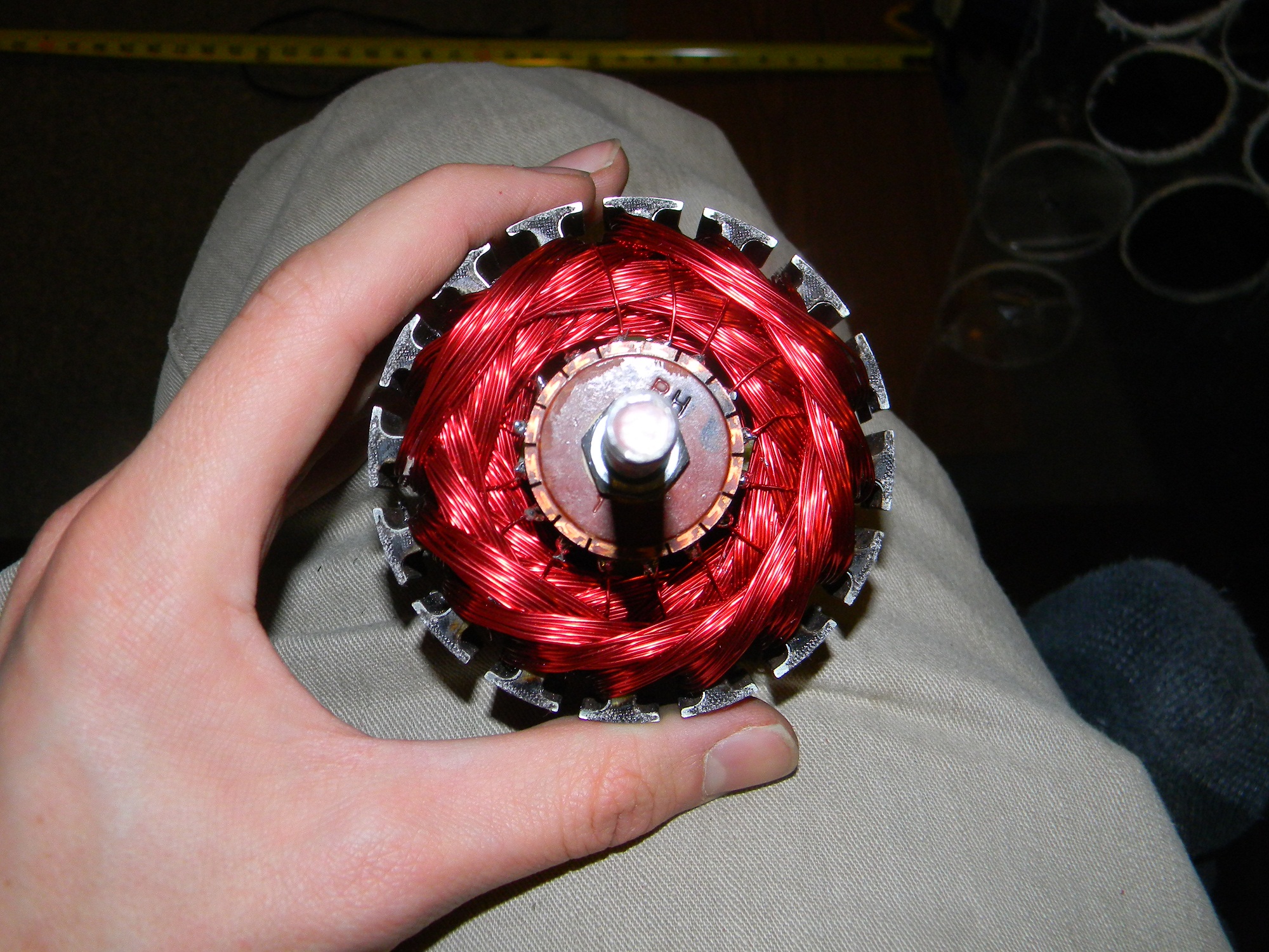

      • Finally finished my 16 pole scooter motor!
        Hello All,
        After having to rewire it a couple times because of some shorts, its finally done and the best part is that it works!

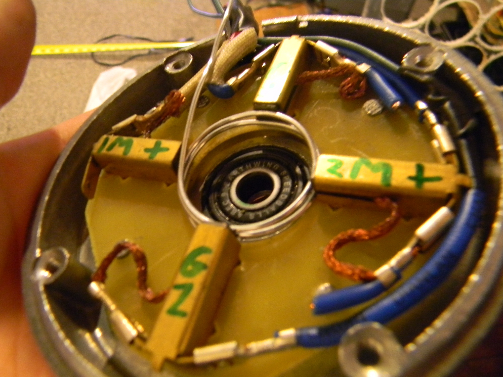

        Heres a neat little way i was able to keep the brushes in while i mounted it onto the back end of the motor.
Name:	commutator jimmy.jpg
        Heres the finished masterpeice:
Name:	16 pole scooter motor.jpg
        and here is a video of it running!
        Asymmetrical modified scooter motor - YouTube
        I need to adjust the brushes a bit, tighten her up, and get the timing just right but she runs well.
        Thanks again guys....
        This replication was done with 16 feet of (i think 28 gauge?) per coil. there was roughly 17mm of space between rotor and commutator. Besides the rotors sharp edges cutting into my wire at first....I used some high temp paper from the motor i took apart and some electrical tape to ensure there wasnt any shorts. I had my volt meter hooked up to it as I was wrapping it to hear if there were any shorts with the diode setting.
        I will be working on making a pulse circuit shortly and seeing what outputs i get from the generator side.
        • That is a very nice Motor!
          Originally posted by warrensk View Post
          Hello All,
          [ATTACH]12964[/ATTACH]
          [ATTACH]12965[/ATTACH]
          Hello Warrensk,
          [IMG][/IMG]
          Wow, very nice winding!...very well set and wrapped...I would say a Master piece..
          Yes, I see you still have to adjust brushes/Pairs bisectors closer to Stators Bisectors, can tell because of start pick up speed is kind of slow still.
          Those Scooters Motors come with 28 gauge?...it is 24 Volts right?
          But, anyways, wanted to tell you it looks great and very neat!
          And yes, it works!
          Ufopolitics
