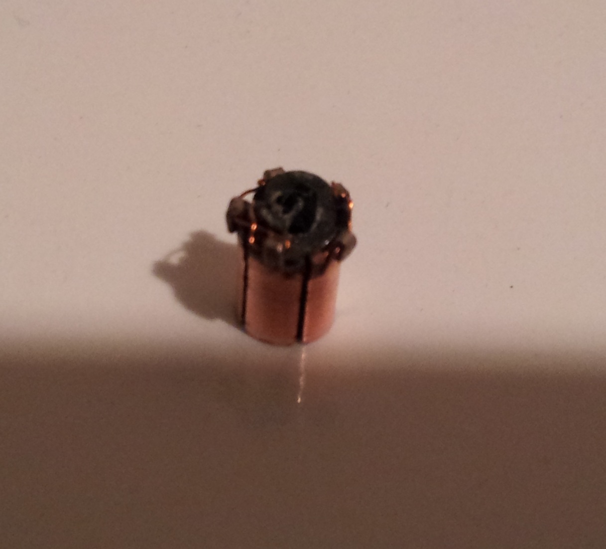

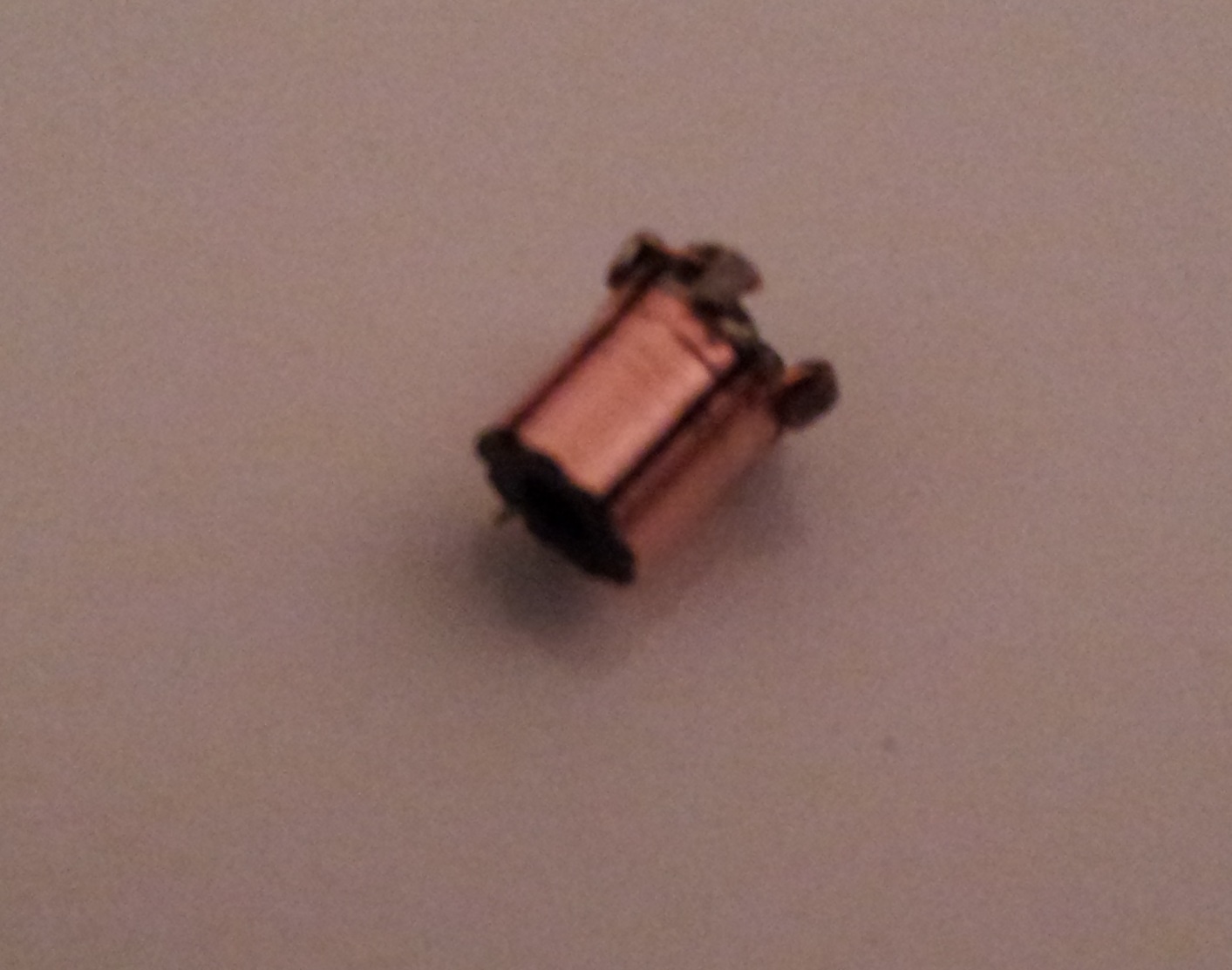

      I got the oscillator working and its running great .
      Now I'm working on the symmetric to asymmetric motor conversion. Just want to let everyone know getting the commutator off of the shaft is a pain! (As john_g said, it is a witch!) Do not apply pressure to the mica base or elements just as UFO said. I learned the hard-way(As usual). Luckily I have more motors, I also may be able to salvage the commutator since I didn't destroy the contact elements.

        Hi All
        I found the commutator to come off vary easy but I did it a different way. After stripping the rotor down, I scraped the paint off of the other end of the shaft and placed the rotor in a vice litely with the commutator end up. Then tap, tap, tap with a hammer on the end of the shaft and it slid down even with the commutator. I then took a welding rod piece three inches long and pushed the shaft out alltogeather with one more tap. Vary easy. It took two minutes.

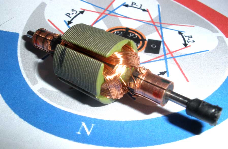

                Five Pole Radio Shack Windings
                [IMG][/IMG]
                Hello to all,
                I am preparing a nice animation to be seen all the windings-connections in 3D...Not to be right away...but coming...
                Now this image will give you the understanding. However, when showing this plan view, I reduced the lower commutator and there are not shown the lower brushes ..it will create confusion, but you all know they are "crossed in diagonal" on this motor, as my video Part 1 explains it. So Output Negative would be the "G", and the one shown on left "M" would be Positive Motor (Input).
                You just wind Pairs of Coils as You just do a Coil, continuously, except going through the angle of the Armature Core, just like a "Bent Coil" in V Shape.
                Now please, this tends to confusion, because once you start winding, you could loose where was your starting point...so, please mark it with a tape on shaft or permanent marker, the side chosen to start all coils.
                Do one Pair at a time, continuous winding and connect them to commutator elements as you go...
                My Photobucket link...in case can not read clearly here
                5P_2S_1.jpg picture by ufopolitics - Photobucket

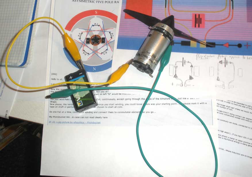

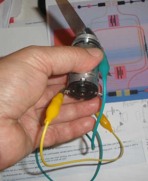

                        Woaooowww !!
                        Ufopolitics you are THE MAN,
                        my replication of your motor works and that on a friday 13th.
                        It is incredible that by connecting the plus and minus totally assymetrically the motor spins and very well.
                        Sometimes i have to give a small quick to get the spinning, but it works great, am totally amazed
                        OK i have to calm down now and go on the experiment and testing.
                        Just for the other replicators. I begin the winding by fixing the wire (for me 0.2 mm copper wire ) at the small hooking point on the collector. Than i begin to wind the first 25 turns as per Ufo shematic, than with the same wire (no cutting) i began the next 25 turns in V shape, than i fix the end on the opposite hooking point on the collector. So the same wire winds the 2 X 25 turns. And that 5 times. My 2X 25 turns (or 50 turns ) gives about 1.6 ohm dc resistance.
                        let's go men we have winner here
                        Anyway great BRAVO and many thank's for sharing
                        good luck at all
                        Laurent

                                Hi
                                Well done Woppy. I have had mine quickly running both ways, goes very fast. Had a slight snag, I used some shellac to seal up the windings, which I thought had dried - It hadn't and spun it out through the motor like a centrifuge! Be dry tomorrow.
                                John
