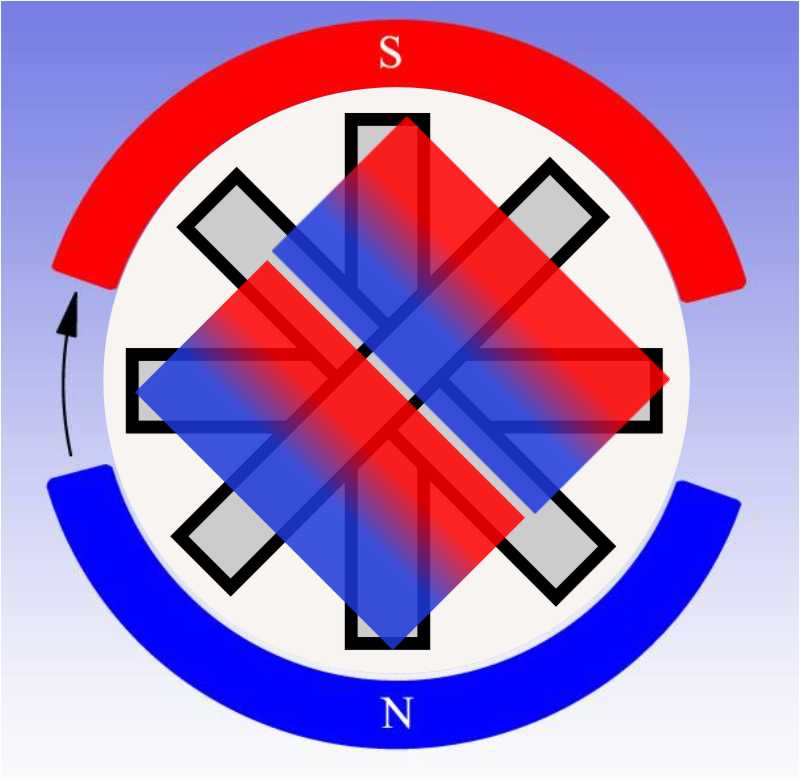

The rpm's kept getting better as that top brush started to get worked in.
My alignment is off as well.
I had 3 wires (ends) come loose ,fixed it , now a fourth is cut.
The force is throwing the wires out.
I had to modify the bottom com. ..I tied all the ends of the pairs together, so a common ground??
All the starts of the pairs are wired to the top com. , so the rotation is by 1 pair firing after the next.
I tried with every other com. section and it is , seems like it's just as strong? But using half the wire?
Some repairs ,then more testing.
