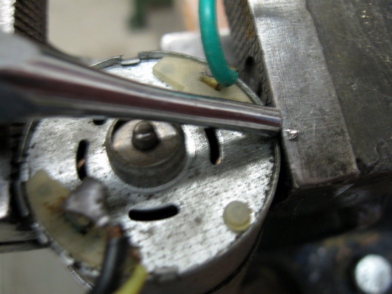

      But now I've got a problem as a motor newbie. I've used electricians cutters to bend back the small tabs at the back of the motor case but so far I haven't been able to get the back part to pull out or off. Looking at the picture below if anyone can offer suggestions on how to get this apart I'd appreciate it. I've got a good metal bandsaw so I can easily just cut the outside case near the back but I think it would be better to have the inside pulled out first to help determine the best place to cute the case.

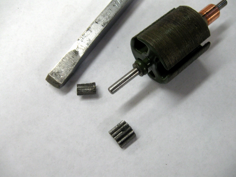

      The "steel" gears are actually powdered metal. Place gear on a steel block and with a cold chisel strike a light blow between the teeth --- it will split off
      the shaft.
      For the tabs use a small punch (screw driver) and in the vise on on the bench, knock the tab back out
      Ron

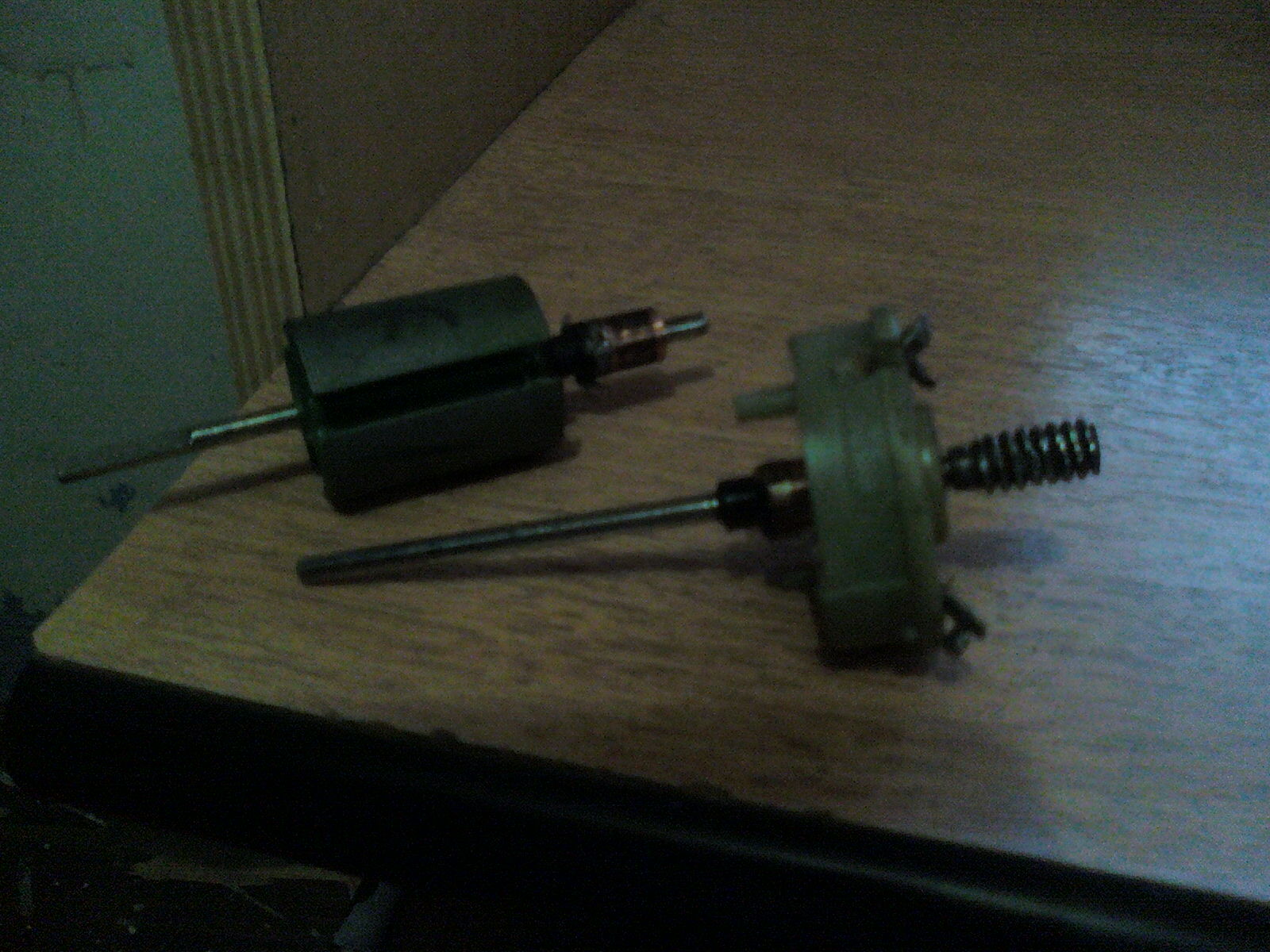

            Can anybody have any suggestion how to remove the thread at the back of the motor, I done almost everything even work, on the opposite side removing everything, the commutator is very stuborn and wont budge, I afraid to crack it because its only the spare I have. Sorry for my English its my second language. thanks
            • first find a nut that fits the thread. screw the shaft in the nut, suspend it in a vise and hammer a hardened (masonary ) nail in the middle. Make sure it does not fall to the ground too hard.
              • Originally posted by MasterBlaster View Post
                Oh Thanks didn't thought of that, I'll give it a try Thanks

                      • Thanks everyone for the suggestions on getting the motor apart. I'm confident now with that knowledge I can get it apart. I've got the tools needed but just wasn't sure of the best ways to go about it.
                          The other Armature I see that is cleaned up...has a perfect shaft and is just waiting for your new commutator...So just cut off the gear off the shaft and take whole shaft out of Brush casing...then you coud worl calmly taking out your comm...
                          Do a "surgical precision" cut there, very fine Dremel ,fine super fine blade to get "inbetween" case-gear...
                          I believe is your best choice Dear...
                          Now once you have comm-shaft out, then press it very EVENLY from bottom with some kind of hollow ring...that will fit-slide within shaft but seats exactly at EVEN Bottom of Commutator...
                          UFO
