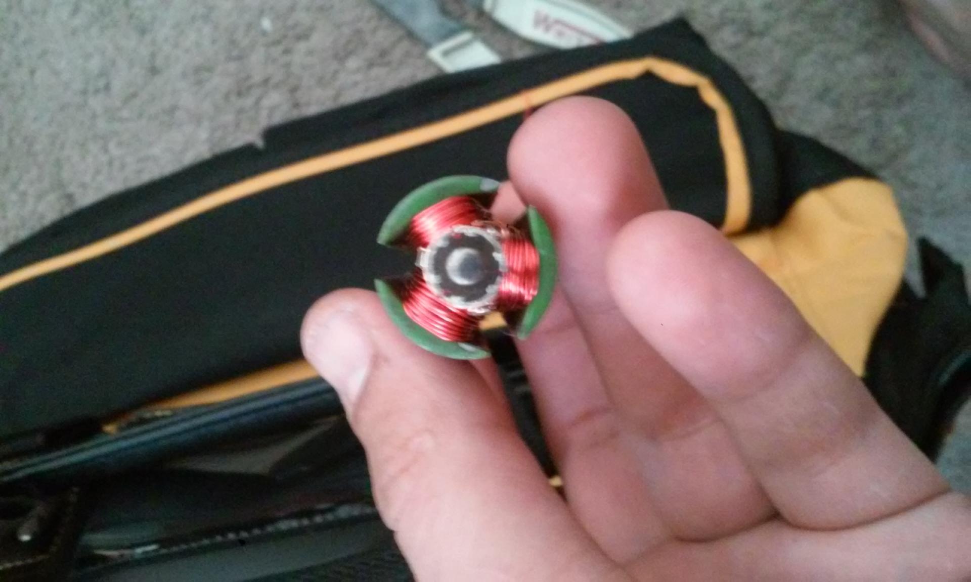

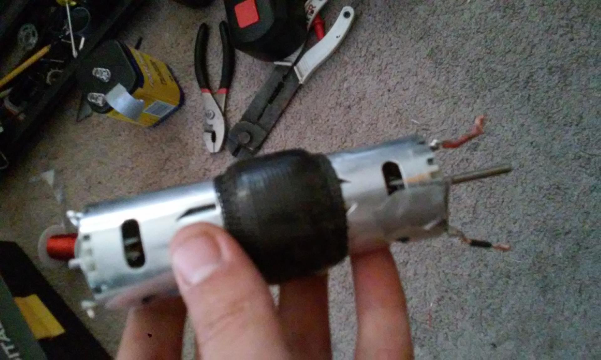

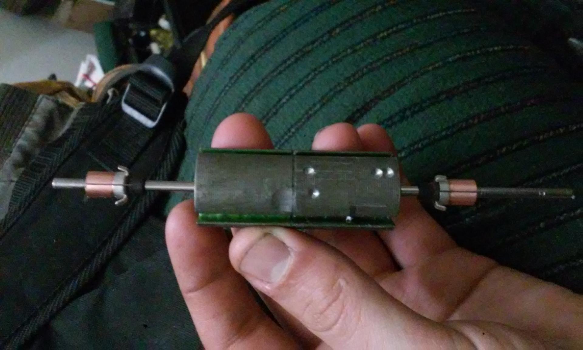

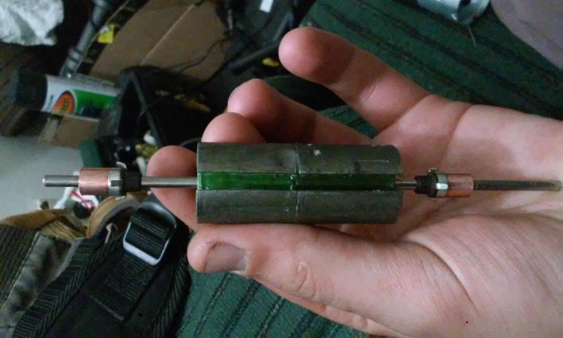

          Ok first on wireing I started last night being excited after receiving your reply to post ufo. I shouldn't have as i and my wife were out with the baby all day and i was tired. being tiredi know I have 300 turn but i know i probably have more. Im going to re wrap to be exact. My question for wiring is reading ohms, from what i have read and gather, each coil needs to be at 1ohm? How do i read that? i get no reading with 300 turns, do i strip a little insulation? will that be detrimental if i scratch it much and continue wiring?
          Ok UFO about the timing, what if you set the commutator a little off center with the armature to were green comm element is slightly closer too green coil yet still complete opposite side? The magnets in the housing are 1x2 I forced the housing manually with my hands as my wife wrapped the fiberfix around housing, some resin slipped throuh and seld magnets, perfectly because they were repelling. My brush housing caps, because of the way i had to take them off, spin freely in the housing to were i can set their position any way id like anytime. Itll be good for finding a sweet spot i can imagine...?
            With 300 turns, even with 16 gauge (awg) you must get a reading, so there is something wrong with meter or contacts or something else.
            If you scratch just ONE wire, is no problem...but two or more strips within short turn distance could short coil...no good.

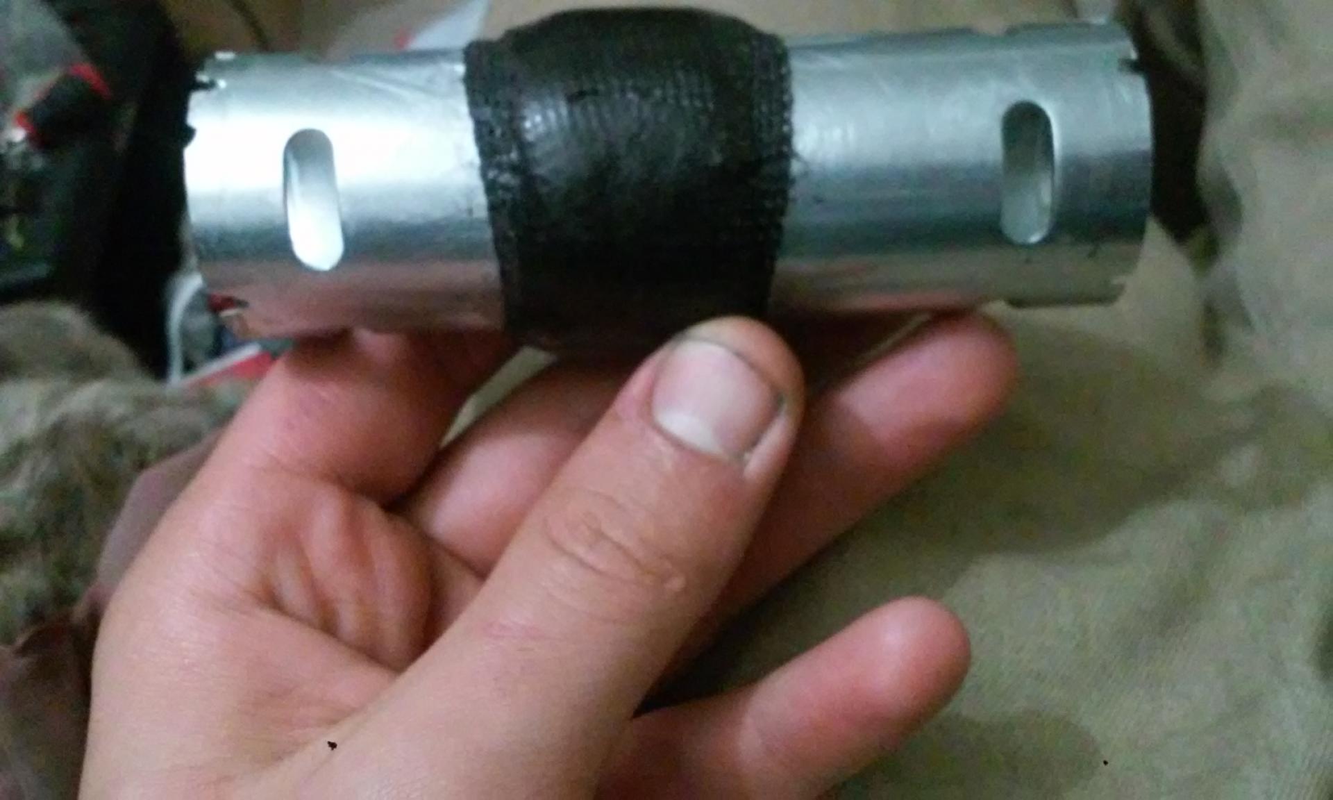

              Nope not the meter i had tested resistors and it zeroes out when probs touch eachother. The question was more do i have to scrape away the insulation and touch the probe to the bare wire to get a reading, asking because i dont want to damage my wire.
              lol I was using 29awg because it was closer to the gauge that was on the motor, funny thing is they had it wrapped with only about 30-35 turns. I actually have 2 rolls of 24 or 25awg but used the 29 worried i wouldnt have enough of the larger lol!!
              ok ill keep that in mind when i start playing with the timeing, What do you think of a bedini circuit recharging the batt that power the motor??
              If someone could please answer about shaving or not shaving away some insulation that woulf be amazing!!! Im itching so bad to get it wired!!!

                Hello YHS,
                I believe 29 awg is too thin for this motor...yours looks like a 550 body type, not the 256 body or the typical Radio Shack is, which is OEM wound with 30 awg.
                I really do not understand why you need to strip wire to measure it before winding coil in motor?!...unless you are going by the wire length table to resistance in ohms.
                All you need to do is to wind ONE COIL first...then strip the ends that are going to attach to the commutators elements and read it from the two end terminals.
                Just make sure you wind very tight, and pressing it on both sides of coil , MAKING SURE to leave room for the other two Coils seating right next to this first one...that is all.
                If you still wanna go with 29 awg, then do like 60 to 100 turns on each coil.

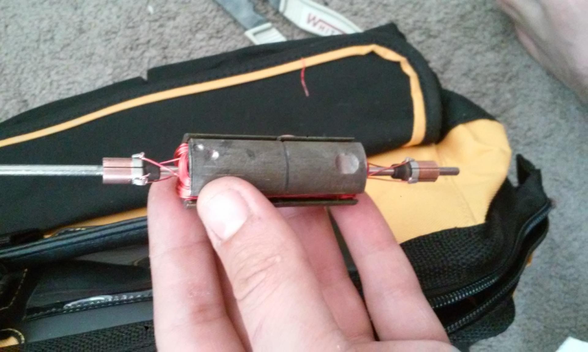

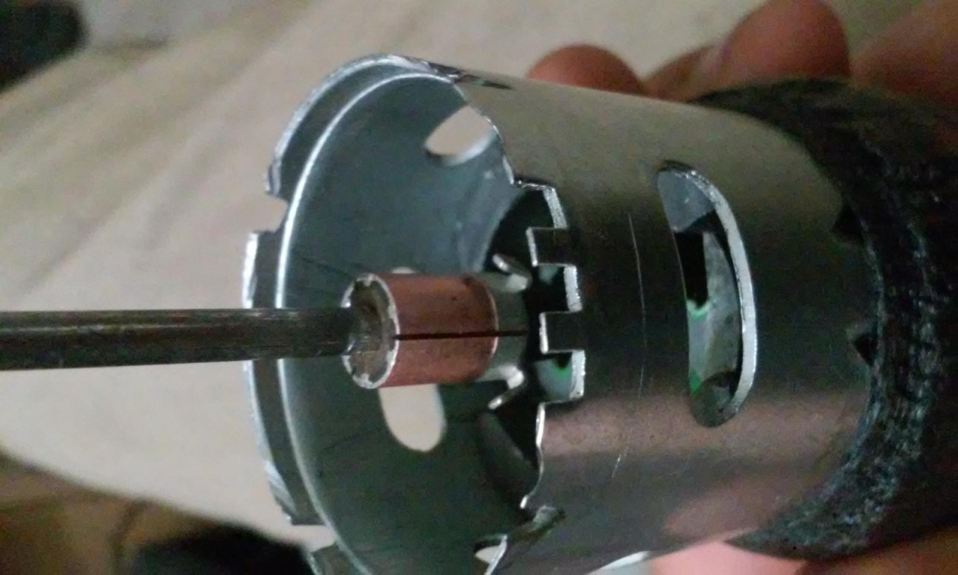

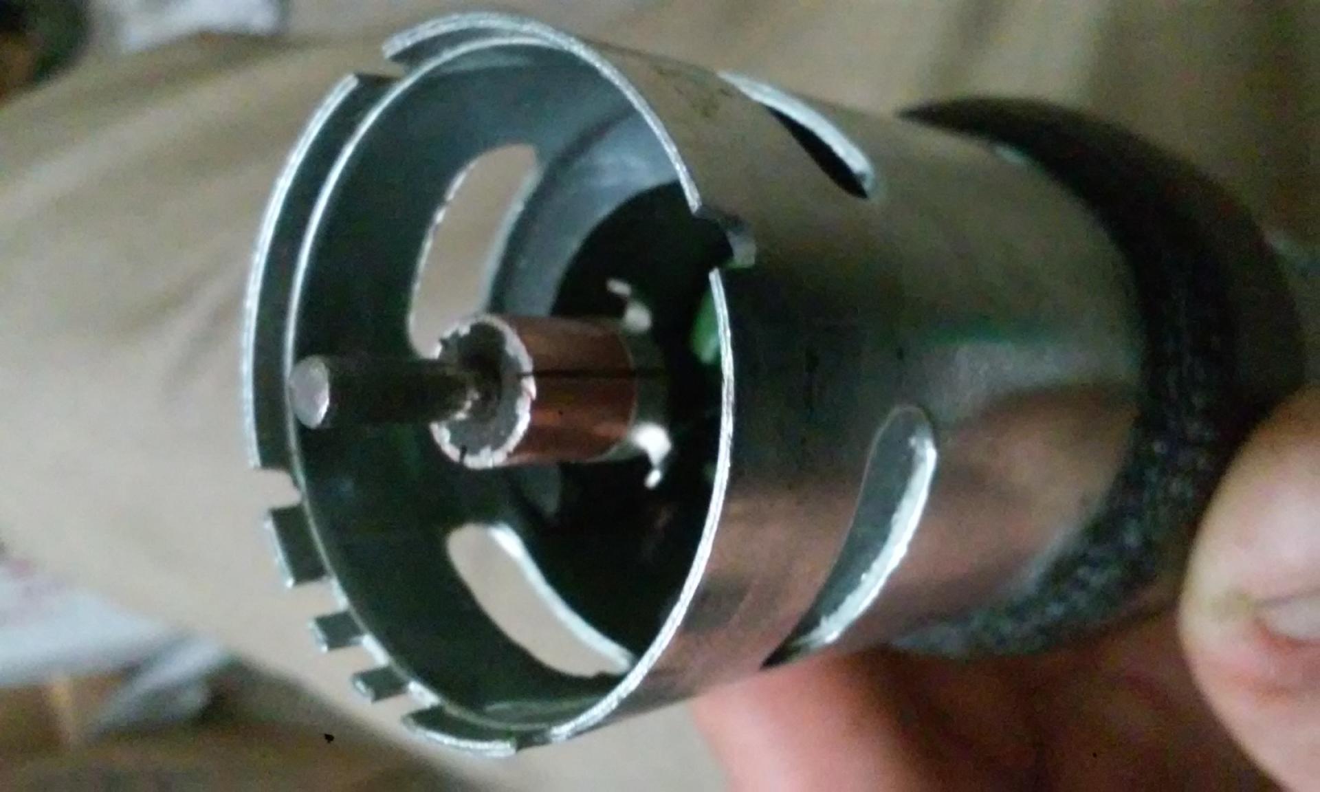

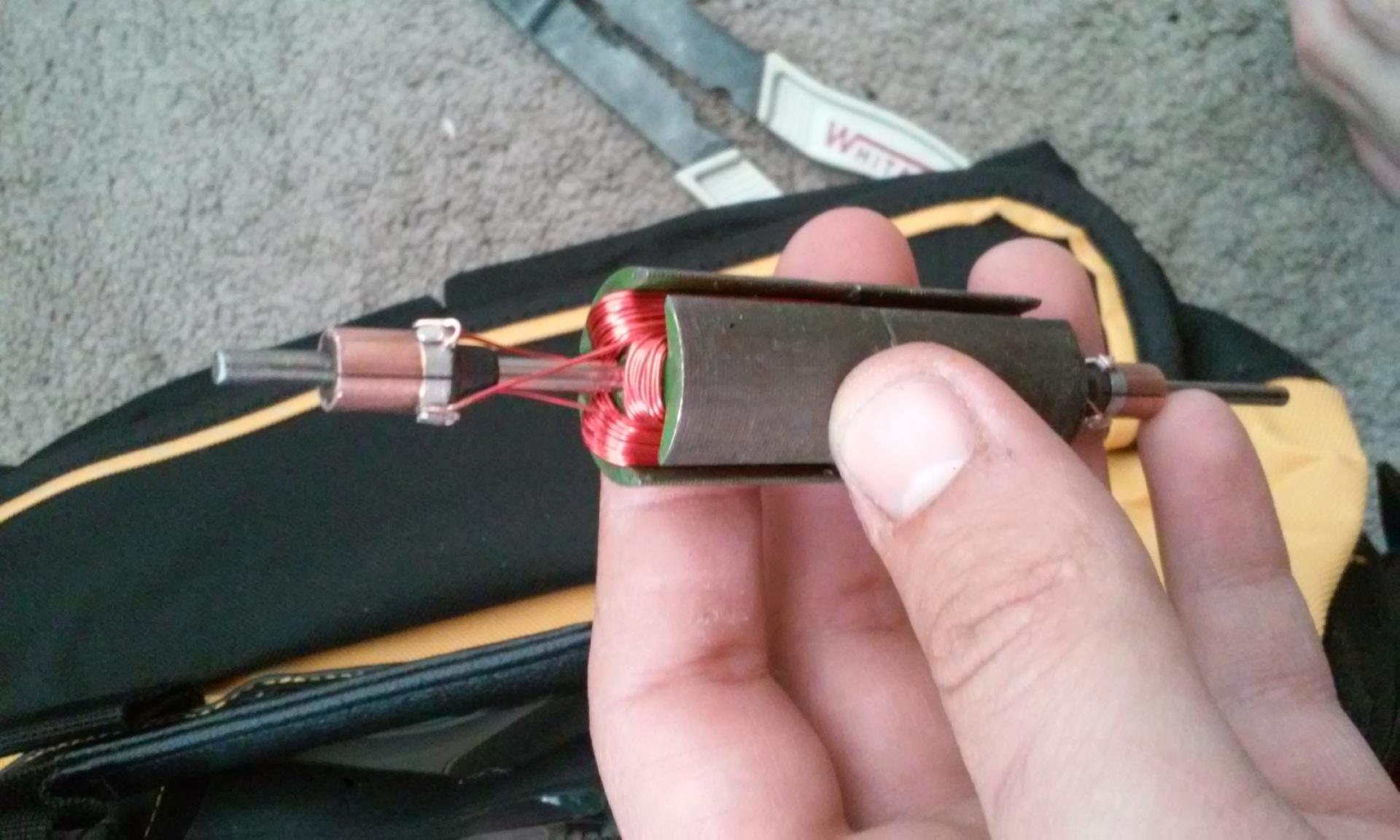

                      Alright so i wired the armatur 33 winds an arm, .5 ohms a coil. I played with neutral fireing position and every other possible but nothing. my brushes start burning and smoking a few firing positions did create sparks. Do i need a higher resistance in the coils or whaaaaat??? any idears?
                      • Troubleshutting...1
                        Hello YHS,
                        Sorry about your problem, first, according to your picture below...
                        [IMG][/IMG]
                        [IMG]
                          Hello YHS,
                          [IMG][/IMG]
                          [IMG]
                          If those are the problems Im sure it is the coils being to small. I did the magnet from a string to tell the poles and its n to n, s to s, it actually made it difficult to join the casings because i had to force the magnets together and hold it while my wife wrapped it with the fiberfix which luckly the resin from it leaked into the casing and bonded the magnets which keeps them from repelling eachother. So ill re wind the coils to 50 turns each should make them each about .7-.8 ohms .. And yes the brushes were first set to the "neutral" position which caused the smoking, actually it was the main location that causeed the brushes to smoke, though the smokeing made me think not enough resistance.
