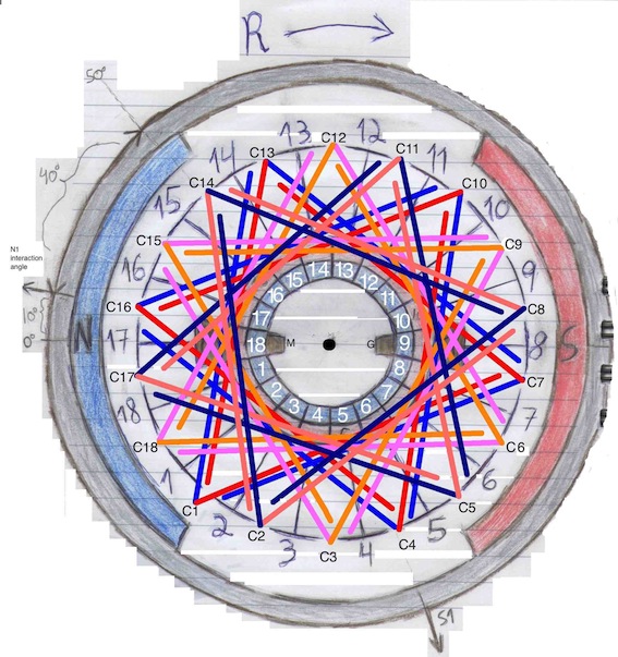

Windings going on here...
Hello UFO and all
THis is my drawing of how i'm winding my 18 poles motor...
Could you UFO Please just check it if it is correct?
I used the idea of the 12 pole motor...
The brushes are horizontal in my motor...
Should i change the angle of one of the brushes?
the blu colors are north
and red are south...
i'm using 10 turns per pole coil summing 20 the north and south pole in series... for each collector...
Thanks again
Fabio
Hello UFO and all
Thanks again
Fabio
