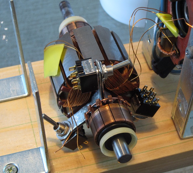

Good morn Turion,
There is something wrong there...it should be Input=Output/2
Input should give you an average value per One Pair...if it is 0.7 is too low, it means around 0.35 ohms per coil...
Output is the adding of the two Pairs, 3.2/2=1.6
Make different turns of shaft and take other read outs (make sure to read first continuity at both terminals)...not right next to, but turning like one quart turn, same direction of rotation.
The Reason of keeping One (1) Ohm, is not to disturb Voltage or Amperage readings, based on Ohm's Law...while keeping a Constant Value (R) to render equal read outs of those parameters...besides not creating a huge short circuit. However we could always go higher but keeping around same values per Pairs.
Please read my post above...
