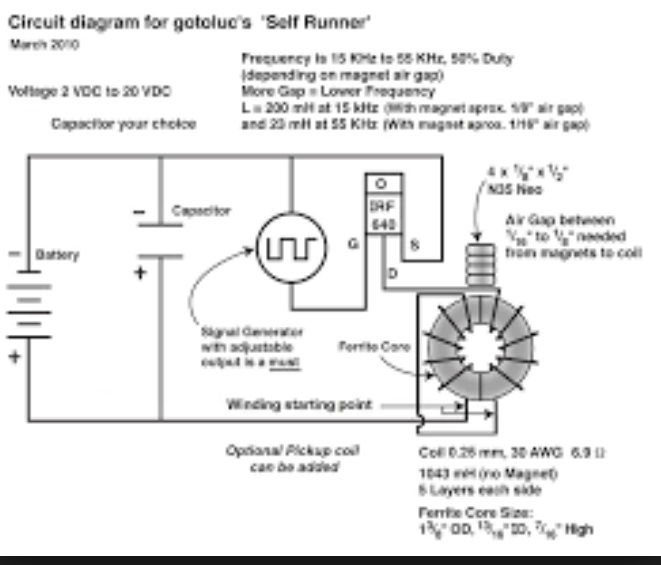

              Here's another question; What happens to a coil's inductance when a powerful magnet is placed close to it?
              I can help answer this one for you, and I want you to put thinking cap on.
              Coil inductance lessens in the presence of a permanent magnet field. The decrease in inductance can be used to measure the strength of the magnet field. Try and understand that. The negative inductance is a measure of the magnetic field strength in adjacency.
              Look at Gotoluc's schematic below; You can see how his coil inductance drops as he closes his magnet space gap:

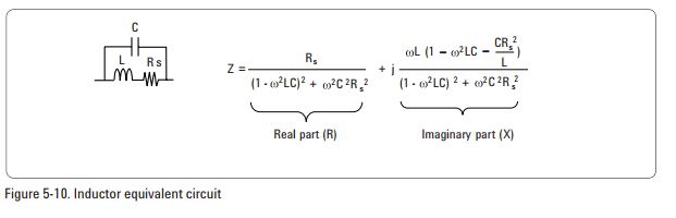

                              • Agilent 2009 Impedance measurment handbook on why the meter shows a negative value.
                                When that happens you switch to capacitance. This is the procedure it states:
                                The measured inductance (Lm) rapidly increases as the frequency approaches the SRF because of the effect
                                of resonance. The maximum Lm value becomes greater as the device has a higher Q factor.
                                At frequencies above the SRF, a negative inductance value is displayed
                                because the Lm value is calculated from a capacitive reactance vector, which is opposite to inductive vector.
