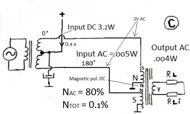

Originally posted by seaad
Ok, let me see if I understood you well...
On your shown graphic ON LEFT SIDE opposed force, all Inducers are changing EQUALLY into LOW, MEDIUM and STRONG...right?
What happens here is that the Field generated by both exciters would REMAIN RIGHT AT CENTER of INDUCED Core-Coil...The Field would just be weaker, mid or stronger, but it will NOT DISPLACE SPATIALLY through the core axis of the Induced, resulting on a weak spatial change hence poor output induction.
Remember Figuera's words..."mimic how the inductors come and go...(get closer to then get further away) from Induced".
We MUST think, that whether repulse or attract, the FIELD TO OBSERVE is the one created by the result of the TWO EXCITERS FACING EACH OTHER'S INTERACTIONS...and NEVER look at, as separate-independent fields for each exciter....and this is exactly when we succeed.
Now, on RIGHT sequence-column, you are taking the LOW TOO LOW.
The Low Exciter should be NOT TOO CLOSE TO ZERO, but strong enough to allow certain magnetic pressure AGAINST the Higher Exciter.
MM mentioned about an 80% on low side, anything below that, then Higher would prevail, collapsing Induction to high side...or making the FORMED field to displace out of range.
Which means the Fluctuations are somewhere in the 20% range. And this is directly related to the resistance or inductance on part G.
Ufopolitics
EDIT 1: I want to also add that when we are EQUALLY CHANGING BOTH EXCITERS, like on LEFT IMAGE,
1-We are "stretching" or better said: dilating the COMMON FIELD on LOW
2- On High we are "compacting" COMMON FIELD.
And so on Mid...is no need to explain...HOWEVER THROUGH ALL STEPS, FORMED FIELD REMAINS AT CENTER OF INDUCED CORE.
