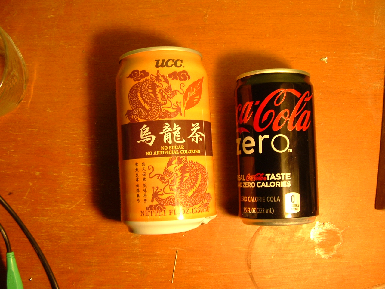

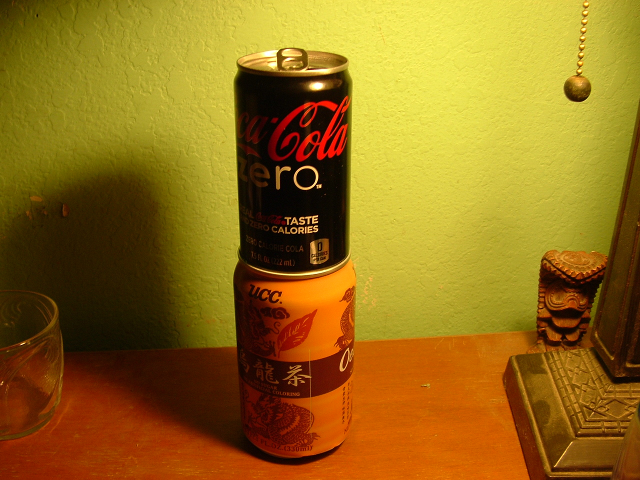

                              Originally posted by lostbraincell View Post
                              Too flat 1/8: steel plates.i used 18" X 30"bottom plate welded 4 1/4 20 nuts to just fit inside paint can. short pipe cut to fit bearing.Welded in center. 5/8" steel stock for drive shaft washer welded to shaft to hold in place.1/2" from that a another washer welded to put disks on.1/4" all thread for stationary plates. hand cut with tin snipes.center disks i used 4 1/2" grinding disks i used this so i could statically balance.used 5/8" washers as spacers used 1/4" nuts and washers as spacers on sheet metal."note" assemble with out paint can to compress spring app 50 lb tension on spring.i made 6 all thread spacers with sleeves from 1/2" conduit so can would not get crushed when putting top on.ujusted by eye tolerances app 1/16" in. i placed sheet mettel, disk, sheet mettle,space,space, sheet mettle, disk, sheet mettle,space,space, sheet mettle, disk, sheet mettle.I found i only needed 4 disks 850rpm heats slowly 1200rpm 31.5 F in 10 min light wt cooking oil.
                              Thanks a lot I appreciate it! I was thinking smaller scale at first...finally found some compatible cans I think--diameter 1/4" apart!
                              • #90
                                It may be difficult to keep the system together structurally. You are going
                                to need bearings at each end.
                                The material is very weak. Can you find a couple of stainless steel
                                vessels, maybe in one of those cheap kitchen supply shops?
