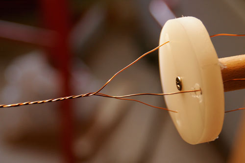

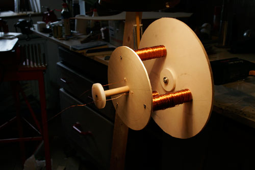

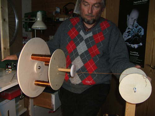

    My way is to build a device like this. three spools on a rotating disc-spun with hand drill on a rheostat, very slowly. the three wires get pulled out thru a teflon disc and to a spool. I hope the pictures are self explaining...

      nice jig albert i need to make one it took me 2 days to wind a 5 strander by hand
      i dont think im doing that again
        Indeed that's a nice and simple rig, would definitely work in my (crammed apartment) environment - it seems ideal for people who do not have 100ft long backyards to stretch the wire back and forth.
          Nice....
          Nice Rig Albert!
          Simple, Compact and Apparently Tried And Tested....

            Albert got some beautiful coils off that rig. It really shows when you take your time in construction. Another method of twisting is just with a electric drill. I made a machine like alberts, but I couldnt get the tension right and gave up pretty quick. Instead I fixed the three spools to a wall on a roller. Next I got a piece of pvc pipe bout 20mm diameter and put a bolt through the middle. Pulled the wires out and wrapped a few turns around the center of the pipe near the bolt. Then put the bolt in the drill and spun it, twisting the wires. It helps if you pinch the wires off from the rolls so there is tension. Once you have sufficient twists stop the drill and wrap the wire evenly around the pipe, i.e. equal turns on either side of the drill chuck, so the weight is even when you start your helicopter pipe up again!
            Its not perfect, and you still have to be patient, but it beats buying twistite from a dealer.
