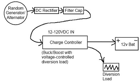

I pondered on a similar project, though I'd try to help.
- Most wind/solar/hydro systems run on 12v (or 24/48v) DC.
- Alternators output AC/DC at various voltages.
- What we need therefore is a good buck/boost converter circuit. The idea would be to plug-and-play onto as many possible generator types as possible to charge your batteries. Then you power your loads separately (either 12v RV/Marine loads directly or 120/240 via inverter).
- Diversion load is needed because it prevents your turbine from over-spinning and blowing apart in high winds.
You could probably make a decent controller with an Arduino/Atmel, PIC, or equivalent and some tinkering. 50khz switching MOSFETs and voltage feedback. I can help if you need some more detail.
