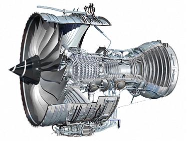

                Originally posted by I_Like_Science View Post
                Because thermodynamics debunks all over-unity/perpetual energy theories, most people here tend to turn a blind eye to it.
                Every tiny corner of this Rolls Royce engine,which has three concentric shafts, was designed with and by thermodynamics.
