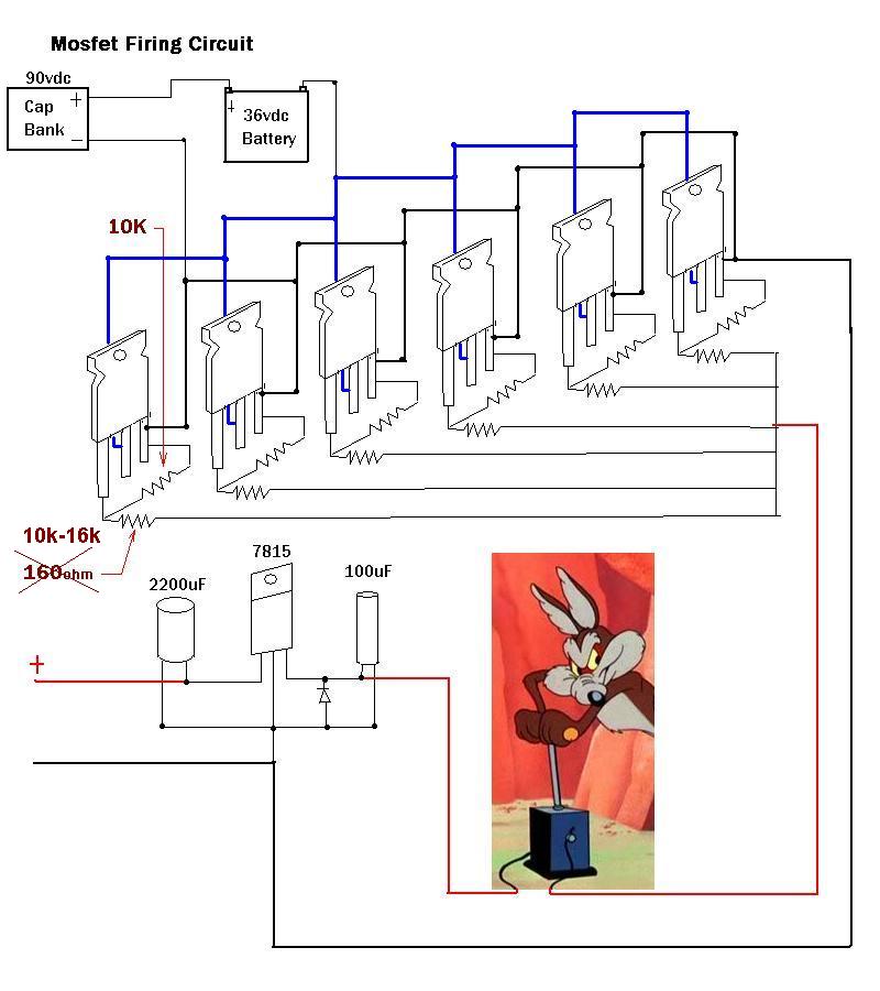

Hello Group Members
I need help. I am ganging up mosfet's in parallel and as I do the resistance drops across the bases I think. I am in the testing stage and when i dump the caps using the mosfet's I hear a tick each trigging. If I stay low at 12vdc it makes the tick sound more quietly and then for 30v dumps it is more audible.
Then the mosfet's short across, so I think my base resistance needs to go higher so I can not hear them dump
It is a simple circuit with 160 ohms in series with the base leg plus a 10k across the source and base.
That's it then I throw 15vdc on it from a regulator and the bases all open.
I have 6 in parallel and I think with one the resistance is fine then with 6 it changes some. 6 in parallel must be lowering the resistance to the point I am going to need more to stop this TICK sound with every dump.
I am using a IRFP250 and I did not use a diode across the Drain and Source yet so maybe?
I will be done soon either way. Anyone who is an actual hands on guy and not just a arm chair scientist I welcome.
Thank you for your support.
Mike
