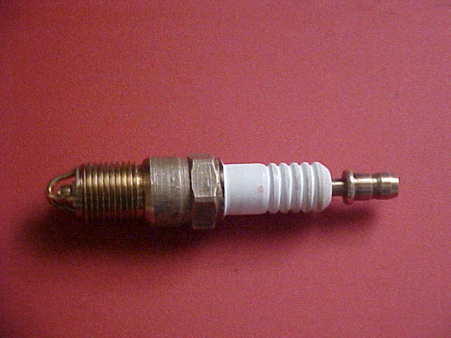

            Prototype Firestorm Plug
            Spark plug consisting of BeCu one-piece center electrode with 3/16 ball on one end and screwadapter on other end, one piece, no welding allowed. Ground consists of BeCu Tri-Arc cage, arcs 120 degrees apart eminating in solid ring. Shell counter-bored, ring inserted in counterbore and welded in place, with equidistant gap of .030 universal throughout 180 deqrees arc of ball.

              Who made this actual plug?
              What result was achieved in testing?
                I don't have much more information. The text came from a PDF from the Yahoo Group "Hydroxy" file section. I believe Patrick Kelly posted it.
                The links above have all the information I am aware of.
                Duane
                Dude, you're curving my space-time.
                  jeweler made plug?
                  It looks like a pic I saw that was a prototype of Krupas supposedly hand crafted by a jeweler.
