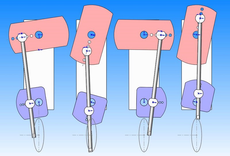

Alternate design for elliptical drive
The attached pic shows an option for creating elliptical drive of the top shaft.
The red plate is driven by the electric motor.
The blue plate is driven by and synchronized with the red plate via chain and sprocket so that they are always locked, rotationally.
The drive bar is locked to the pivot on the red plate, but slides thru the pivot on the blue plate.
By changing the offset on the red plate you can adjust the length of the ellipse.
By changing the offset on the blue plate you can adjust the width of the ellipse.
A Heim joint on the end of the ellipse shaft would accommodate the top shafts change in angle and height as the top shaft moved through it's elliptical path.
Not knowing exactly how the top of the machine was put together, this is the design I had for my build as it would allow for just about any path configuration of the top shaft from extreme ellipse to circular, without having to rebuild anything to test different settings.
John

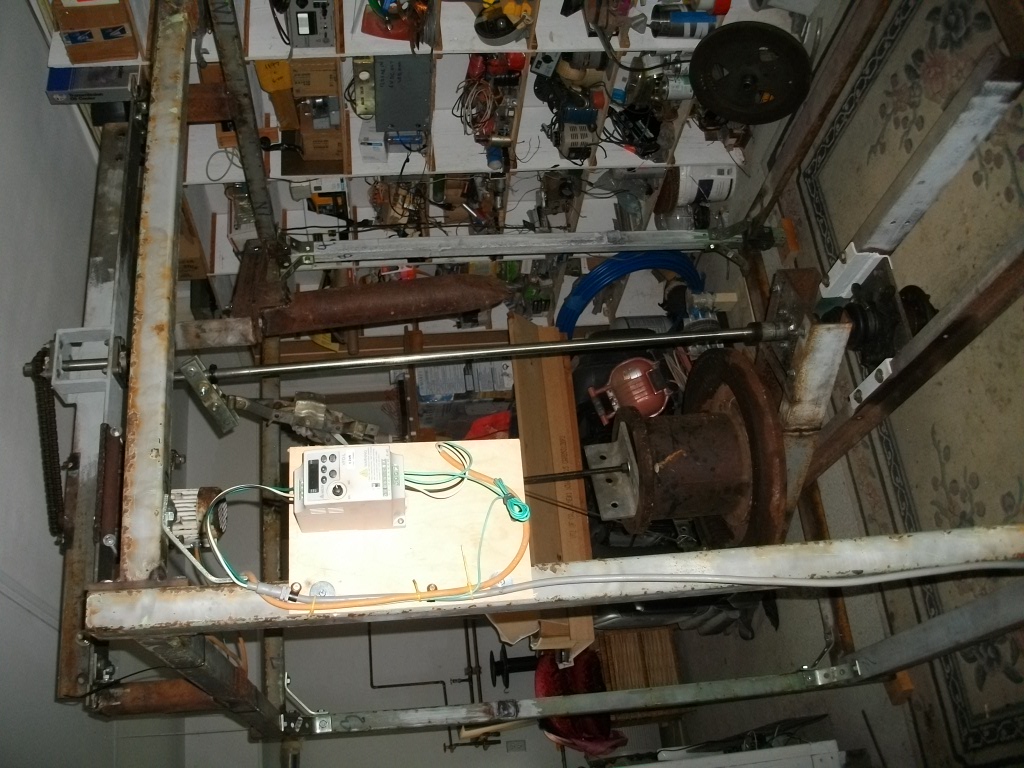

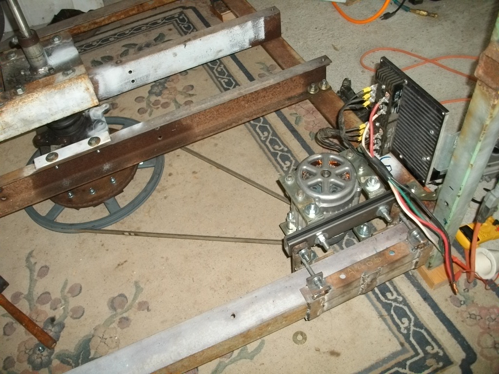

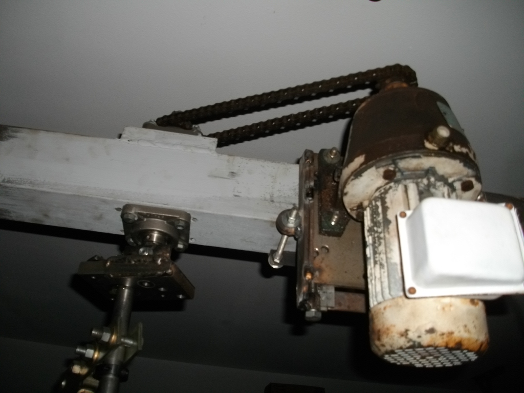

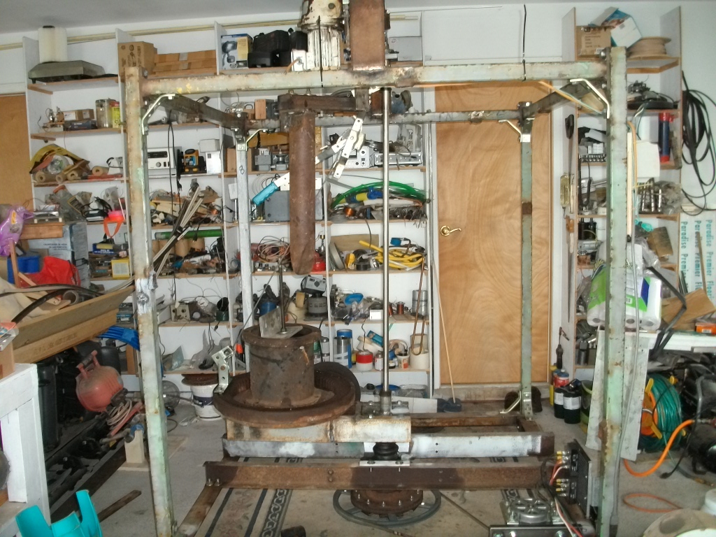

Hi guys,
The machine that are being discussed here I built it, it took me around four months to come to this completion, not finished yet. Enjoy the pictures. Frame size is 5 ft by 5 ft and the height is around 7 + ft. The lower weight is 340 lbs and the upper weight is around 75 lbs. As you can see the upper weight it's totally adjustable, you can slide back and forth if you want to. The driver motor is a 3 ph 1/8HP with a 56:1 gear ratio planetary gear it is controlled with 1/4 HP VFD drive. When I turn this thing on it's scary to stay close by! So I stand back 5,6 ft away when that 340 lbs rotates at 33 rpm or little higher you have to respect the "force in motion" under no load prime mover motor consumes 80 to 90 watts, the output power is still being tested!!! During the operation the frame sways a little but I have plans to make it firmer by installing cross braces all around the frame. Come along tool is temporarily hold the lower weight and does a good job with it. 90 decree weight lowers the input power close to 25 to 30 % anyway if you have a ? or comment drop me a line. If some of you need help? I maybe be available to help you design yours.
The best mechanical OU devices seem to shake like a demented banshee
mksboysal, that is quite a construct. I believe you are in Hawaii. I'm sure that it is more difficult to find parts there.
