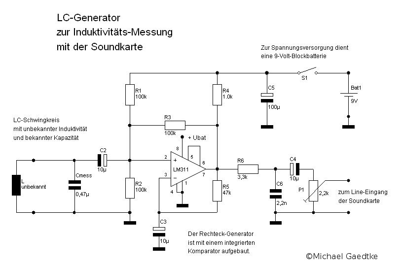

    Hello,
    I found a nice circuit for calculating the resonance frequency also the capacity from a Coil.
    It works with your line-in plug from a soundcard and a lm311 chip.
    The original Circuit can be found here.
    Spulen messen mit der Soundkarte - Michael Gaedtke
    Translated Link
    This is what the program looks like what you need to download from the link below.
    I did measure here the bigger Coil from a microwave oven.
    Here is the circuit itself.
    Have fun.
