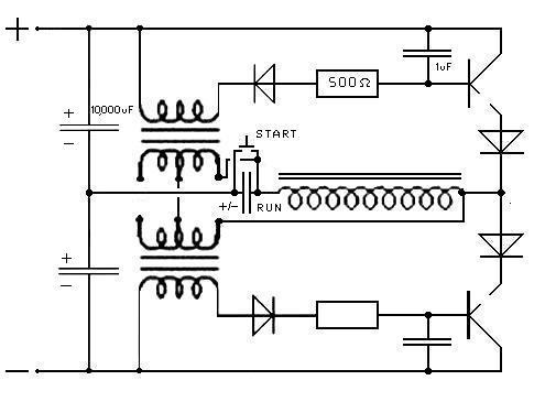

hi all. i been thinkin about trying a capacitive discharge circuit on the rc motor.i saw a variation of fig 1, i moved the components around a bit, in a vlad utkin pdf. the cap will charge up to and hold higher alternating potentials with every flip. it looks like a very efficient way to ac pulse a motor with a dual polarity supply,or a virtual one.apologies for speculating here, i know i should investigate it first,but i think this could go a bit feral on different types of brushless/pulsed motors.heavy ripple on that cap though.
ok. with 122uf bipolar electrolytic,(not ideal,higher esr) it runs the same with the run cap active or shorted.with 200 uf it was off a bit.caps across b-e on t1 t2 stabilized the switching. i'm after 1 pulse each way per ac cycle, 7 cycles / revolution.
8.4 dcr in the motor winding might be bad but having more turns,inductance might be good. also the bemf signal that the iso trafo's read shows a nearly identical light pattern with the timing lights,with the run cap active or shorted, about half a degree of advance.so i think that part is ok for now.maybe more voltage will stir it up a bit.18v ozito power so far. i can only muster about 20uf of film block type and motor run capacitors.maybe i can get it into the zone with 40 v or more with the good caps.
fundamentally it's a series lcr circuit that has it's coil in a motor. i think the bottom line is series lc is min impedance at resonance and the frequency varies in the motor according to v and load,so a fixed capacitance means high impedance over most of the rpm range,or all of it. this calls for a dynamic self adjusting on the fly variable capacitance.i guess varying motor conditions and rpm/frq both need to be accounted and suitable adjustments made.
i would appreciate any suggestions on how to accomplish this.
come to think of it if it had a parallel resonance the same as the series resonance that might flat line the impedance for varying freq,rpm. but then still too much impedance maybe.
cheers
