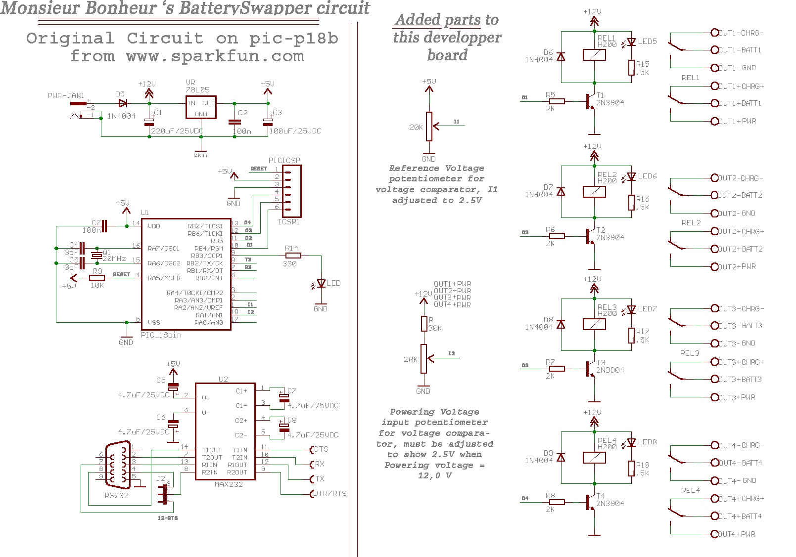

Voltage Sensing Circuit
I think what you will find with the above circuit is that the voltage sensing part of the circuit is all referenced to ground.
The issue is that with the 3 battery switch, the first battery's negative is not at the same "ground" as batteries 2 & 3. If you're using the ADC of a PIC for the voltage sensing, it will work fine for batteries 2 & 3 if your PIC ground is on the negatives of batteries 2 & 3, but you'll have to be creative to get a reasonably accurate voltage reading of battery 1.
When Bits and I were working on the Tesla Switch we ran into that problem, but we did find a solution for it. He went on to use the same logic for the battery swapper he had at the time.

The most solid way is to use Isolated ADC's. Toshiba makes few that are reliable in high noise areas. Anyway you can build a module per battery or battery set. Each module can be independently switched on and off using an SPI enabled Power distribution switch(PDS). The PDS will turn the power on to the ADC module and the ADC will broadcast on 1 line isolated from the battery. So 4 pins total from your pic. Best part no power consumed monitoring when you don't need to.Originally posted by John_K View PostI think what you will find with the above circuit is that the voltage sensing part of the circuit is all referenced to ground.

Thanks Matt, I didn't know those things existed. I'll do some research in that area and see if I can find the device you mentioned.Originally posted by Matthew Jones View PostThe most solid way is to use Isolated ADC's. Toshiba makes few that are reliable in high noise areas. Anyway you can build a module per battery or battery set. Each module can be independently switched on and off using an SPI enabled Power distribution switch(PDS). The PDS will turn the power on to the ADC module and the ADC will broadcast on 1 line isolated from the battery. So 4 pins total from your pic. Best part no power consumed monitoring when you don't need to.
