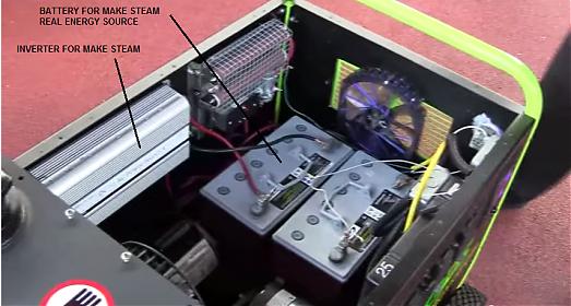

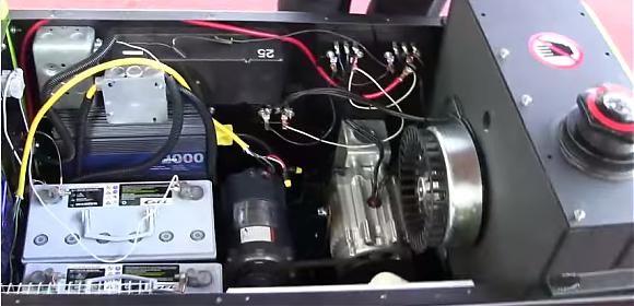

A quick glance on the inside reveals 2 large batteries and 2 converters.
With those alone you can probably have 3000 Watt for one hour.
And then you will need to charge your batteries....
I think you can buy these a whole lot cheaper.
Ernst.

Fake!!!
The fake generator work in this way....
The first battery is associated with an inverter and power an resistor for make steam inside the water tank , the steam run an motor that is connected to the generator and the little generator charge just one battery , I suppose 12V 100-125Ah, that is connected to an 3kw inverter. There are two inverters and two batteries inside the generator. Water is used just for make the steam!!! The man do no use more load like an electric stove because for me can't work. Of course you can use 3Kw but just for an very limited time. Is completely different from an standard gasoline generator. The water isn't used as an fuel!! To the end who recharge the first battery used as the real source of energy?? In other words do not buy it!!!
