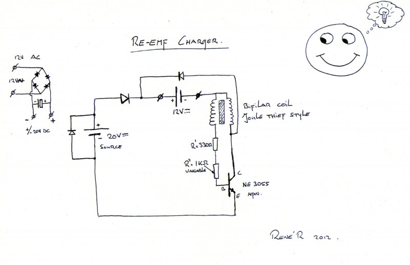

          hi dave.that last one looks like a stungun/taser circuit.
          i haven't tried this myself, but it's claimed to be very efficient.

            and by all accounts(as in multiple impressed replicators) this is a weapon of a desulfator/charger.supply voltage is higher than charge voltage on this one.

                I added a valve to the schematic this should allow C2 to siphon electrons from the ground circuit as its being charged.

                  The problem I have in testing this circuit is Q1 needs to be ran at high frequency and Q2 needs to be ran at 60 hz.
                  I dont know will have to think about it awhile.

                    hi dave.that's a yes.to clarify the bit in brackets,plenty of people have replicated this and given it glowing endorsements in their feedback.it's a beast.just google re-emf charger. cheers

                      I cleaned up the schematic some
                      We'v been taught to look at schematics in conventional current flow but if you look at it from an electron flow perspective the circuit makes more sense.
                      When the transistor turns on electrons flow from the neg side of the 24v battery into the coil and ultimately into the neg side of the charge battery.
                      When the transistor turns off the collapsing magnetic field sends a pos charge to the pos side of the charge battery through the diode.
                      The charge battery is getting hit on both sides.
                      There are two sides to every story
                      Follow conventional current flow but also look at the schematics in an electron flow perspective and you may get a little more insight to whats happening in a circuit.
