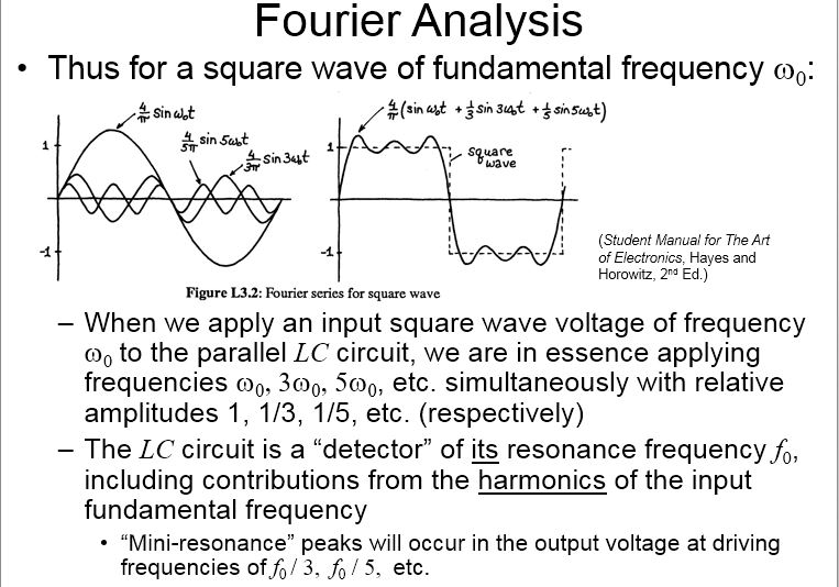

  • Just to share an idea about using square waves to achieve the mini resonance if the main resonance is difficult to achieve :
    the full document is here :
    Code:
    http://go.owu.edu/~rakaye/PHYS275/Diode%20and%20Resonant%20Circuits.ppt
    • Hi Med.
      I just think about the ODD harmonics in the Parallel LC contour ( 3,5,.etc).
      From the other build I remember the ODD harmonics are "destructive" in the system while EVEN harmonics are Aditive?
      • Originally posted by John.K1 View Post
        Hi Med.
        HI John.
        i only tested the square wave using the output from NE555 oscillator, using the scope i only achieved 24khz as max frequency even thought NE555 may achieve 200 khz very easy!!! the circuit i built is variable frequency/duty , the capacitor used to set the frequency is 10nf , so i think the chip is very old.
        i achieved the mini resonance using normal parallel L/C in low voltage mode using these generated square wave, i remember i got two point of resonance, the amplitude will vary also as you know, in the scope the output wave was stable, i think this is good, i am planning to apply HV square wave on the E-TBC, but the problem is the low frequency i got !
        • Just thinking if you know what is the resonant frequency of the device, supply it with the double of it. It should mute the ODD frequencies. I think.
            can you explain more ? thanks in advance

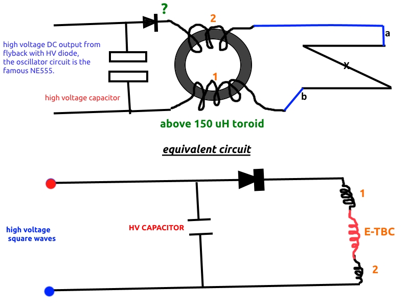

                  • Hi John !
                    i would like to know your opinion about an idea came to my mind, i propose using a toroid with the E-TBC to achieve the resonance with easy, here you are the circuit :
                    i suppose the E-TBC to be just like a coil, the impedance of capacitor will be in minus, the system will form a complex impedance but the resonance can be achieved very easy using a variable frequency NE555, i would like to know your opinion about using the diode ?
                    i did some calculation and it appear the resonance can be achieve...

                        As i see the video in Russian, but this is another video, my idea consist of using another high inductance to avoid the need for high voltage capacitor, for example 2uF /15KV isn't easy to find, in other hand they are very expensive, adding high inductance with the E-TBC in serial, together we form a parallel system, now a low capacitance can play in this resonating system, for example i have 300nf /10k capacitor, 100nf HV capacitor can be built locally with aluminum foils.. i am asking about the resonance how the E-TBC will act, can you imagine ?

                            i tried long time ago to simulate the E-TBC, but it need a lot of time, most powerful simulator isn't free, the trial version are very limited, upon all this you need some times to be used to work with electromagnetic simulator ! so i forget about this.
                            the proposed circuit is very simple since we already know how the ETBC will work, the objective is to achieve a good voltage value across this device all the time !
                            • Just bare in mind that diode is not as easy as it looks. Diode has one way flow if we speaking about + and -. But has also flow when you have - and 0 (still difference of potentials)
                                if i have the answer i wouldn't ask you , the diode will block the inductance to oscillate back, while it's possible for the high voltage DC spike to charge the capacitor ( i am wondering about this ) ? if the capacitor can be charged to high value or no ?
