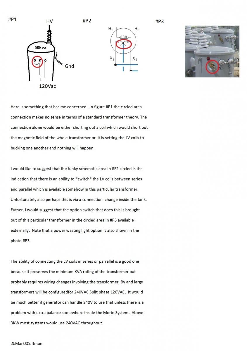

Also to newbies;
These transformers like all other device have manufactures specification
sheets showing all the options. I suspect no one of us wants to admit we are gringoes
at power electronics enough to ask for them - they will vary between manufactures.
Also the nameplates on the transformers are heavy duty - strictly useful information
for determining if you've got a 25Kvar 14.4KVAC capacitor vs. a transformer.

Also to newbies;
