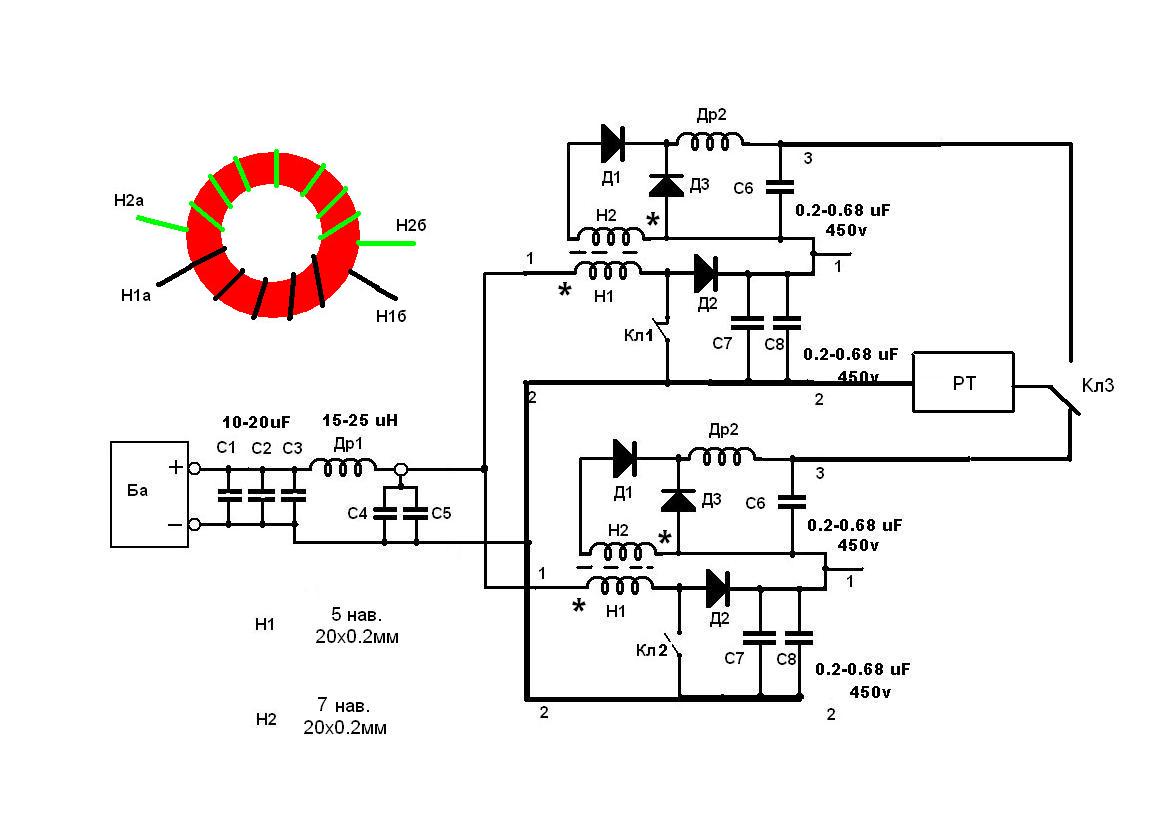

    Hi
    Only in russian but schematic is there, very efficient and usable not only for car.
    info : https://yadi.sk/d/slBXB8oddrfon

      Hi

        I have not been able to translate the documents yet so
        I don't understand his circuit.

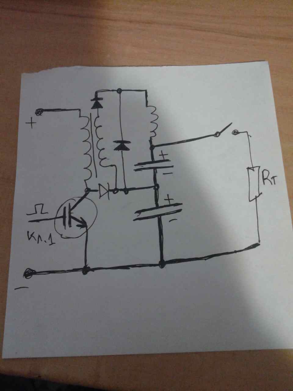

          Circuits I found so far
