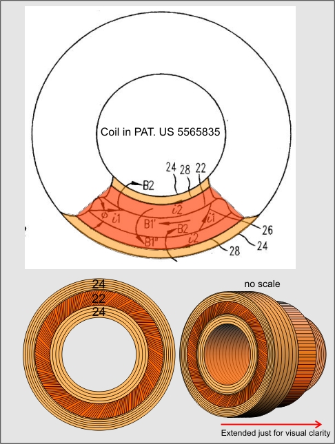

Hi Chet
Attached a pic drawn based in the fig. 2 from Pat.US55565835
As English is not my mother language, it is a bit difficult to visualize the description of windings.
Would you, please, confirm or mend my interpretation of such windings ?
Your answer will be much appreciated, thanks.
regards
regards
Alvaro
