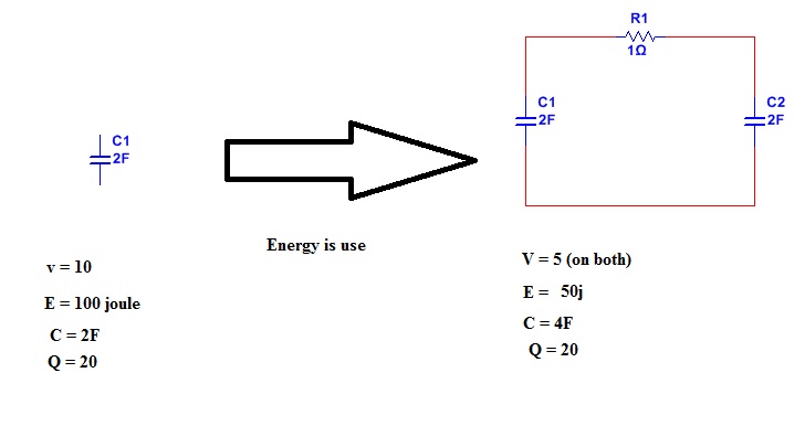

        • #19
          In your 1st circuit:
          All 100 Joules of energy in C1 is transferred to resistor R1.
          But in your 2nd circuit:
          ONLY 50 Joules of energy is transferred to resistor R1
          25 Joules of energy is transferred to C2
          25 Joules of energy stayed in C1.
          50J (in R1) + 25J (in C1) + 25J (in C2) = 100 Joules.
          All 100 Joules of energy is accounted for.
          You 2nd circuit proves: FREE ENERGY is a MYTH.

                This is a linear regulator circuit. The series resistor R1 and R2 will sense the voltage change in the capacitor and feed it to the op amp then control the amount of current flow by controlling the resistance on the transistor.
                I am not going to discuss the detail operation of this device because you can read all about it on wiki here
                I have actually done that with batteries and small bulbs, charging one battery while discharging another battery through a bulb in series between the batteries. Batt 1 lights the bulb and charges Batt 2 then you swap them and do it over and over. What that simple experiment shows is very similar to the 3 bgs, the load can be run much longer in that configuration than just simply running the bulb from the 2 batteries directly.
                already solve this with the first equation i showed. when you power load with series capacitor, only half the energy is use by load, another half goes into capacitor or battery, that why the load run much longer.

                  • #24
                    Are you talking about this one?
                    If yes... I currently have to disagree with your statement. I have figured out a way to test the theory behind this schematic and performed the testing. It has shown that there is no conservation of energy going into the series cap, in the end all the energy equals what you first had initially. I tested this concept with manual switches and a 470ohm load and a stop watch. I was surprised at the end result, but I had to know for myself as others told me the same thing that there was no conservation of energy.
                    Now if one uses a switching inductor that may make a difference, however my testing has not gotten that far yet.
                    -Dave Wing
