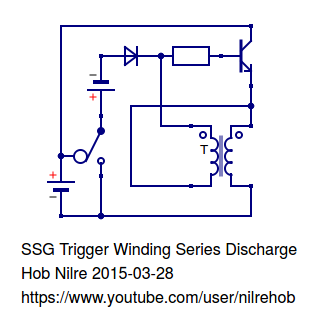

SSG Trigger Winding Series Discharge
Here is a new variation on the SSG:
It only has one diode.
Both trigger and power windings are discharging in series into the secondary battery.
Here is a video:
Here is a schematic:
It has both normal and generator mode where generator mode is selected in the schematic.
/HobLast edited by nilrehob; 03-28-2015, 07:06 PM.Hob Nilre

Recently I went to fast diodes, what number do you run? I thank you 4 your video of single battery mode not so good 4 the battery.
My new diode doubles my output 4 the same current input. I guess I had really bad slow diodes before.

My diodes are usually SF16G but I'm open for suggestions for better ones.Originally posted by BroMikey View PostRecently I went to fast diodes, what number do you run? I thank you 4 your video of single battery mode not so good 4 the battery.
I am still reading your report, BRB
Mikey
/HobHob Nilre
http://www.youtube.com/nilrehob
45ns is pretty fast, I like it. Some are higher voltage say 1200volt, your device is only 400volt. Even a 1000volt is better. Maybe HITBY will chime in, he is the master of diode reality.Originally posted by nilrehob View PostMy diodes are usually SF16G but I'm open for suggestions for better ones.
/Hob
I only just started using FAST DIODES but mine handle 30amps. The 2n4007 is 4ns at a higher voltage but I don't know what to tell you is better for sure.
We will leave that up to the guys who know.
Anyone? Know?
But your diode is way better than what everyone else uses.
Aaron told a number of a new diode but I am not sure on that because I didn't try one yet. Maybe they call it ultra-fast?
One thing is sure. When I use higher voltage ceilings of fast diodes my output doubles sometimes for the same draw on the input.
