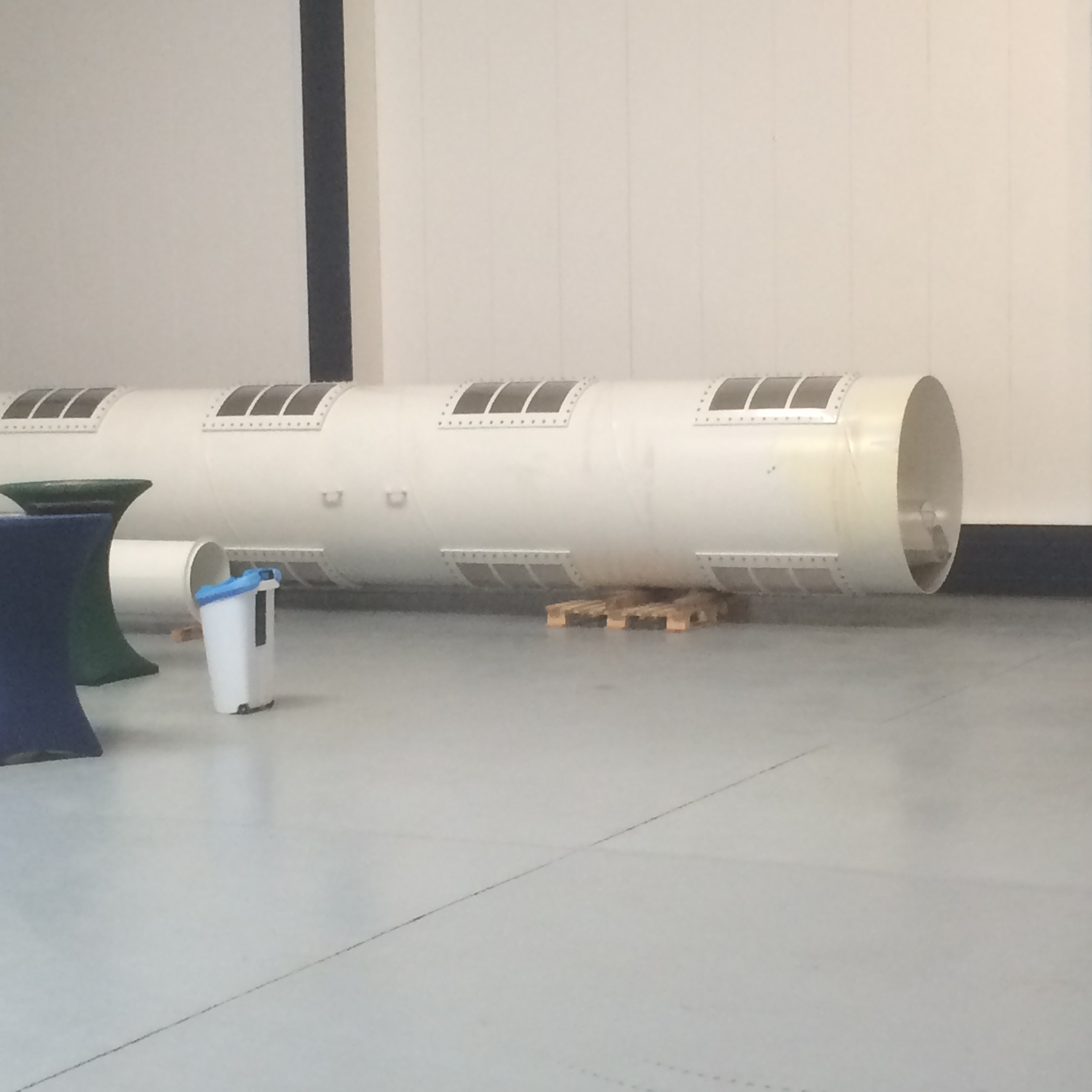

                Rosch taking orders on OU Bouyancy device.2015-04-25 15.12.50.jpg - directupload.net
                2015-04-25 15.13.19.jpg - directupload.net
                2015-04-25 15.13.33.jpg - directupload.net
                2015-04-25 15.19.32.jpg - directupload.net
                2015-04-25 15.27.38.jpg - directupload.net
                Seems to be probably a scam to get money from gullible people...
                The orders have to be fixed at the 6th of May already before all
                preorder guys have had a chance to take even a look at it...
                All very fishy right now.....
                Also.
                They probably have a hidden cable again inside their Tube holder rods which are fixed to the hall walls. There they probably input the power going up to the generator sitting ontop which will again idle only with no real load and as it is about 4.5 Meters up you can not see it very well from the ground, so nobody will again see the shaking chains, that a Lenz law generator can not have at 5 KWatts load...!
                ( This was also the case at the Belgrade demo unit)
                The only way, they could have pulled it off, if they would have a Lenz law violating generator, which would have no backdrag , but then they would not need these buoyancy floats and could just couple a good motor to this special generator and then they would just have a QMOGEN...no need for all this water floats bull****...
                The maximum theoretical possible power coming out of such a device would be around
                160 Watts mechanically from the buoyancy of these floats, but not 5 KWatts ! Also it would then need more than 160 Watts for the compressor...but they claim only 100 Watts input into the compressor...very strange...

                There is now a first witness report who also posted these 6 pictures and he said, that Rosch-Gaia said:
                "Believe in it and buy it or get lost..."
                This seems to be their attitude right now...
                No technical measurements allowed in this moment... maybe only at the last
                day at the 6th of May and then only on certain measurement points they provide...
                They even did not publish a complete picture of their system !
                Sounds all very fishy...
                Regards, Stefan.
