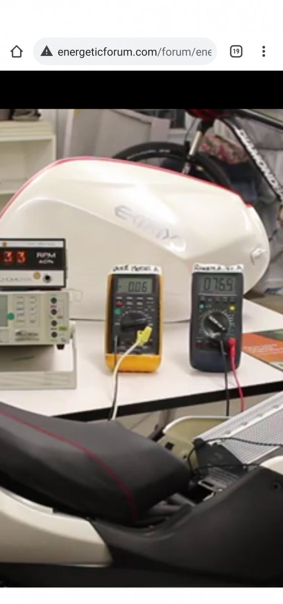

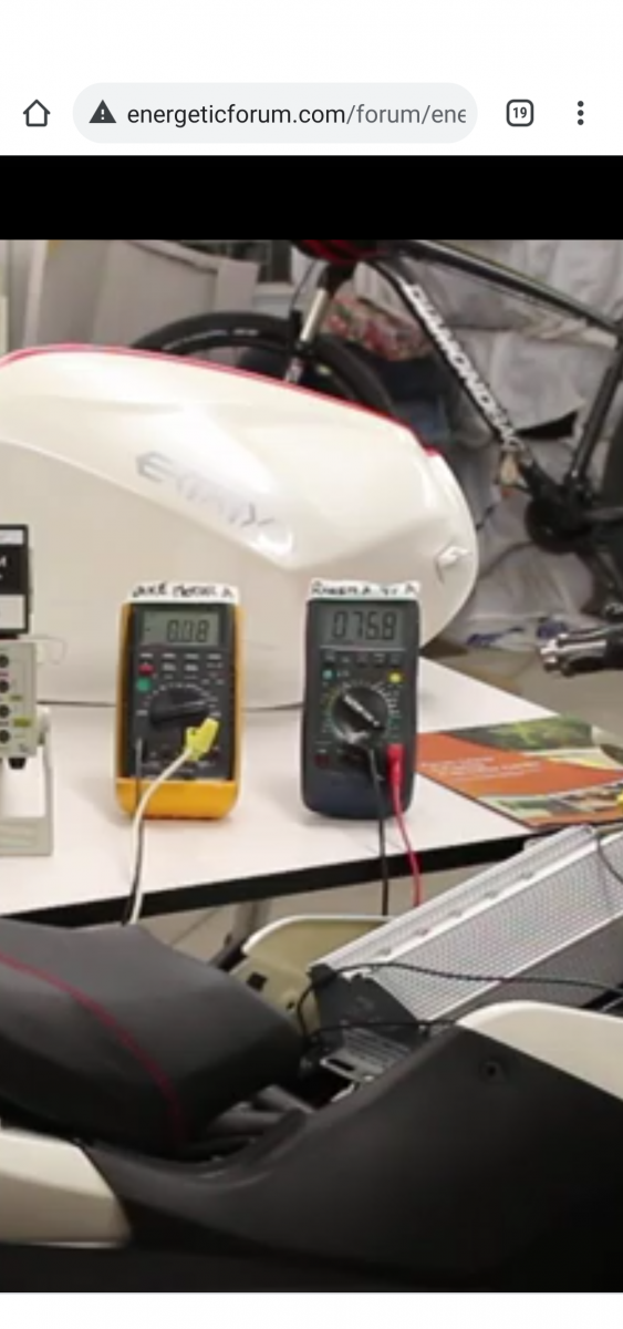

                    Look at the ammeter display. It is negative both before and after the switch. If it actually changed from negative to positive it would indicate a change in current direction, as in discharging to charging, but it does not change. It is always discharging at 74-75 volts.
                    Here's a couple of screenshots after he turns it off. Notice how the voltage climbs as the current goes to zero. This indicates the battery had been discharging and then recovering potential once the discharge current had ceased. If it had been charging, the voltage would drop when the charge current ceases.

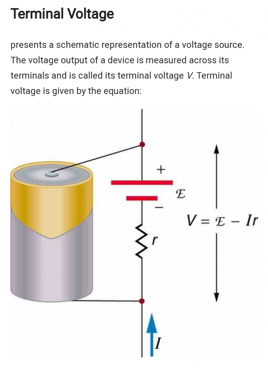

                                75 volts is less than 76.9 volts, the open circuit (resting) voltage of the battery after he opens the switch disconnecting the load. The battery was discharging. The 75 volt reading is the battery terminal voltage which is equal to the open circuit voltage minus the current times the internal resistance. Look it up. That is proof that the battery was definitely discharging.

                                Ref. http://oer2go.org/mods/en-boundless/...104/index.html
                                Do the test which I suggested. Learn something.
