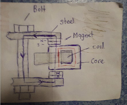

                • Hi,
                  I had this rough diagram I wanted to put out there for consumption. Although I think it is in the spirit of the first experiment in SkyWatchers latest thread, I thought it might be better if I posted it here so as not to be too bigger distraction.
                  It is a partial side view of an axial flux generator with a two piece rotor, that is bolted together, as it passes the gen coils. The hope here is that the flux made by the generator coil, ignores the rotor, and chooses it's closed circuit path. It's untried and untested by myself.
                  The blue shows the flux path that does the inducting, when the generator is not conducting, and the red shows the hoped for flux path of the gen coil when it is conducting.
                  Edit....... ps I forgot the washers that space out the 2 pieces of the rotor.
                  • Originally posted by lotec View Post
                    Hi,
                        Hi,
                        the design is fine, in fact in the network there is a configuration of this type that has only the magnets on the one hand, this configuration has been configured and working to have double pole its N and S by the inductive part of the core will be more V / amp.
                        when I visualized in other images of the network and had only one pole, I thought that why not close for the other end with the opposite pole.
                        You can also try the top where the coil is not, the nucleus can be separated as Mr. Alex does.
                        all these prototypes should be tried with a small replica and according to the results try to make one of larger size and capacity, as well as wind turbines from 1000w to 2500w or more, the advantage if built with this coil anti lenz would move easier .
                        forward continue with your projects greetings

                            Hi Alex,
                            Thanks for the comments on the diagram. As far as whats out there on the network, I don't know, I only visit this site for alternate energy, I figure that most of the things out there will find their way here sooner or later.
                            The dual rotor test bed was a project I started working on and it was going to be used to test a few different inductors, One of which is a distant cousin of the Faraday's homo-polar generator, where the hope was it would output four times the voltage, and it would be AC. That project is on hold for now until I get access to better tools like drop saws and drill presses,
                            I have to ask, There is this guy called Alex, It looks like he is the inspiration for SkyWatchers latest thread, and also the above diagram, and also your name is Alex.
                            Are you that Alex?
                              Dear colleague! Anti Lentz is a great "duck" of General science, tucked among those who are looking for the formula of their device. This figure correctly shows the formula of magnetic switching, their total vector, action-counteraction, rotor rotation, which will be minimal. But the magnetic flux in the core and how EMF is formed are fundamentally wrong. Apply the "right hand" rule to the solenoid core, to the electromagnet and as the receiving coil of the external field of excitation? You won't see the difference. The greater the external flow, the greater the attraction between the magnet and the core, and more EMF.
                              Hi Rakarskiy;
                              Thanks for the reference to the E core generator. Ill have to look into it more before I'll understand it properly.
                              cheers.
