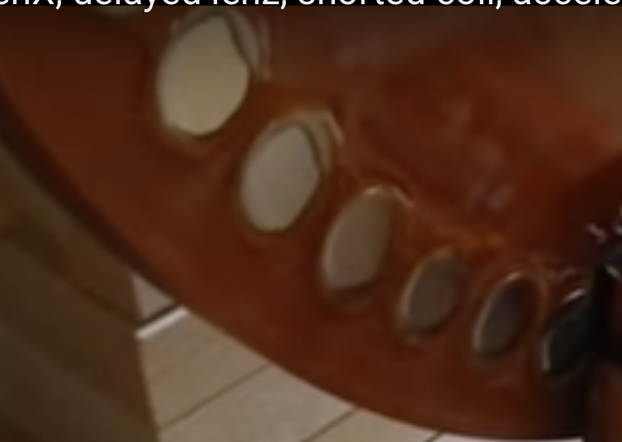

Look at the output on the coils in this video. He has no shielding around his coils.

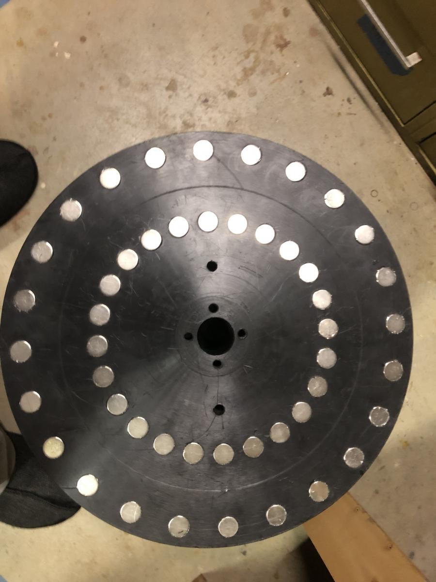

And the simplest thing to do to test that idea would to remove every other magnet, so I would be left with 10 on the rotor instead of twenty. That would remove the existing 10 of the same polarity, since they are in a N/S configuration right now and I would be taking out either all the N or all the S if I took out every other one. Once those 10 are removed, I would have to then remove every other one (of the 10 left) and reverse them so that the remaining magnets were all N/S. I may get to that point, but not there yet. Even if I get down to 10 on the rotor, that's four MORE than I had with the original rotor, and that rotor put out 130+ volts per coil.
