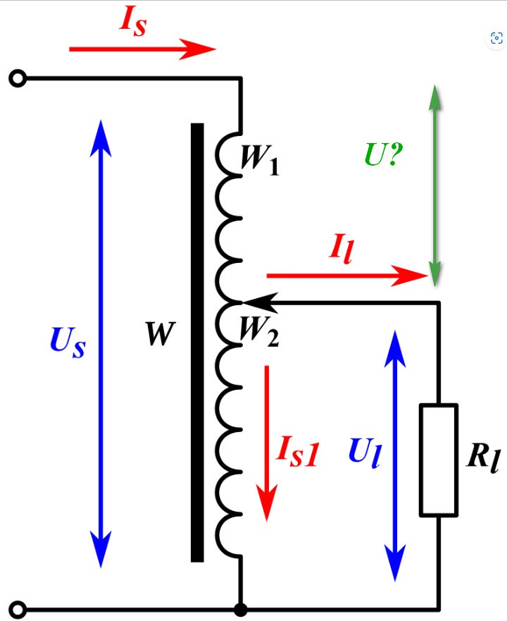

    I am attaching an autotransformer circuit (LATR - laboratory autotransformer).
    If you look at the circuit and label the winding parts as resistances, you get exactly what I'm talking about.
    There is practically no reactance under load. Only the active resistance of the wires remains. Thus, it is absolutely acceptable to use the system as a voltage divider.
    Sincerely.
      Sincerely.

      Hi Rakarskiy,
      You are mistaken. You say:
      "Thus, it is absolutely acceptable to use the system as a voltage divider."
      This is untrue. Take a few minutes and learn about it. The device is a transformer and must be treated as such.

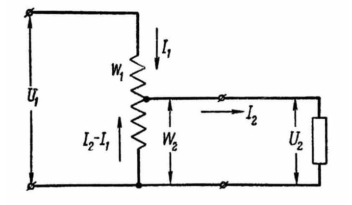

      • You didn't convince me. Firstly, this is the direction of current strength (I [A]) and voltage (U [V]) in a real circuit, they are opposite.
        What is hung in such educational books does not in any way reflect the real movement of current. In the experiment, there was just a divider effect (voltage reduction system)
        Take half the period of the voltage sine wave and see how it looks in all areas. Do not forget that this transformer has a zero terminal, it always has zero.
        Click image for larger version  Name:	2023-04-05_180601.jpg Views:	0 Size:	31.8 KB ID:	512358
        The ratio of EMF values is expressed by the formula: E1 / E2 = w1 / w2 = k, where E is the EMF, w is the number of turns, k is the transformation ratio.
        Considering that the voltage drop in the transformer windings is small, it can be ignored. In this case, the equalities: U1 = E1; U2 = E2 can be considered fair. Thus, the above formula becomes: U1/U2 = w1/w2 = k, that is, the ratio of voltages to the number of turns is the same as for a conventional transformer.
        Without going into details, we note that the ratio of the current strength of the upper coil to the load current, as for a conventional transformer, is expressed by the formula: I1/I2 = w2/w1 = 1/k. It follows that since in the step-down transformer w2 < w1, then I2 < I1. [In other words, the output current is much less than the input current.] Thus, less energy is spent on heating the wire, which allows the use of smaller wires.
        I think this phrase is enough not to think that more than I calculated was put on the generator rotor. The СOP ratio is maintained.
        https://rakatskiy.blogspot.com/2022/...ransducer.html
        An autotransformer efficiency of 99% can only be achieved with a small difference between the input and output voltages.
        In the experiment 220/117 = 1.88 (almost double the difference), thus no more than 0.6 [45 W (in) * 0.6 = 27 W (out)]

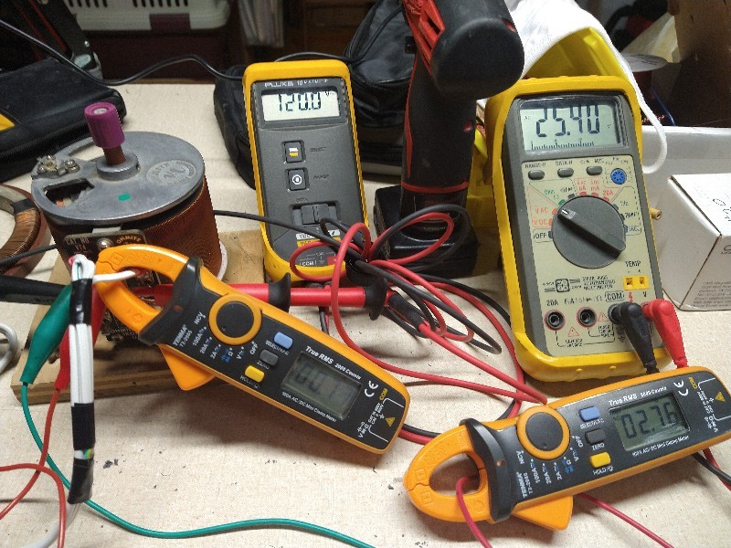

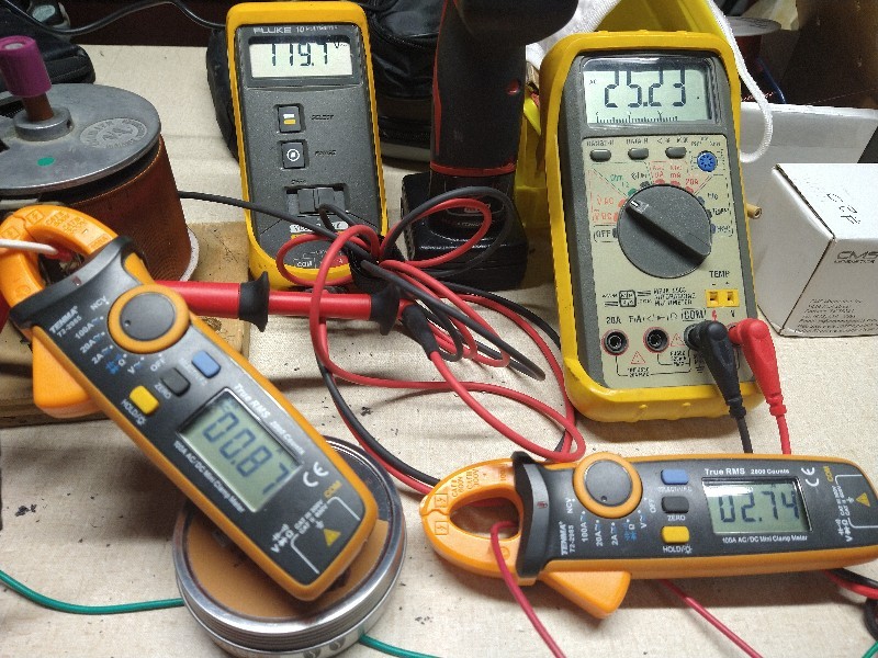

          {edit}
          Added test photo and data.
          Click image for larger version  Name:	IMG_20230405_124955912_copy_800x600.jpg Views:	0 Size:	179.4 KB ID:	512360
          Meters on left read input. 119.7 Vac & 0.87A. meters on right are output into resistor. 25.23Vac & 2.74A.
          120 step down to 25 Volts. 2.74A obviously higher than 0.87A.
          That quoted statement is wrong. And the variac or autotransformer cannot be modeled using a voltage divider (resistor network) as you claim.
          Test and photo taken 5April2023 by bi.

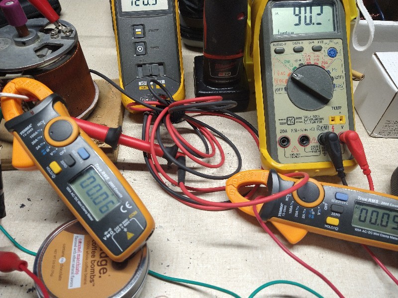

              Well I'm pleased you recognize your mistake. It is also a mistake to assume the single point efficiency shown in my test would apply elsewhere. The variac is sensitive (rating wise) to current and my test point was near the upper limit for the old variac. Other points which I ran yesterday at lower currents showed markedly higher efficiency. I've saved several meter snapshots. When I get a few minutes, I'll add some data here via edit.
              edit
              Click image for larger version  Name:	IMG_20230405_124750962_copy_800x600.jpg Views:	0 Size:	175.8 KB ID:	512363
              This was at the same load point but a bit sooner before the variac heated. I read 0.77A putting efficiency at 76%.
              And another, at lighter load.
              Looks like 89%.
