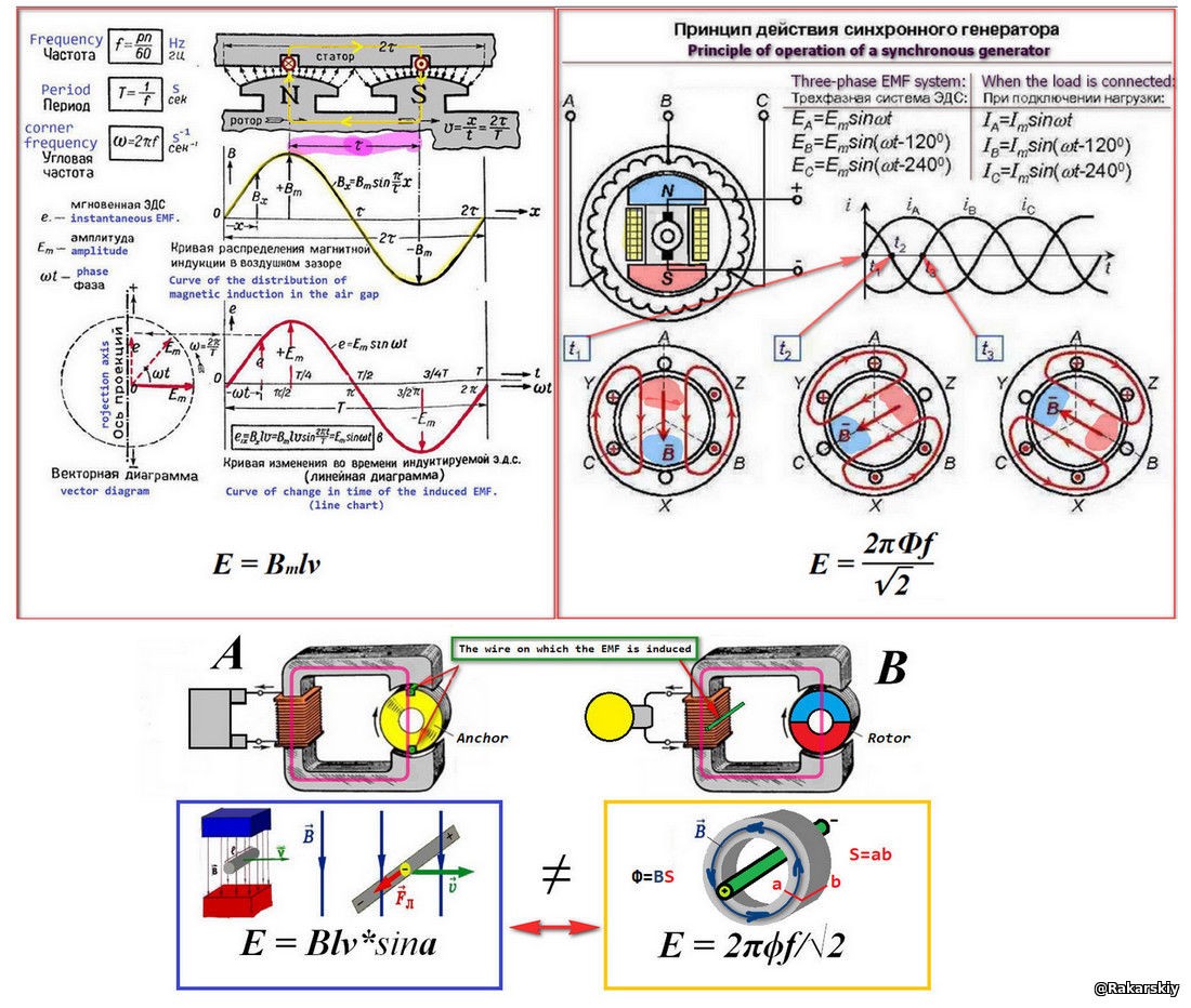

Originally posted by Rakarskiy
Refer to the attached diagrams and equations, found in so many textbooks.
The explanation you seek concerns the difference in the terminal voltage between loaded and no-load conditions. It is obvious that difference is the two terms containing the armature current, jIAXS and IARA. For the no-load or open circuit terminal voltage, Vt, equals EA. Under load, IA is present and there is a voltage drop in the armature winding and reactance so Vt is lower than EA.
