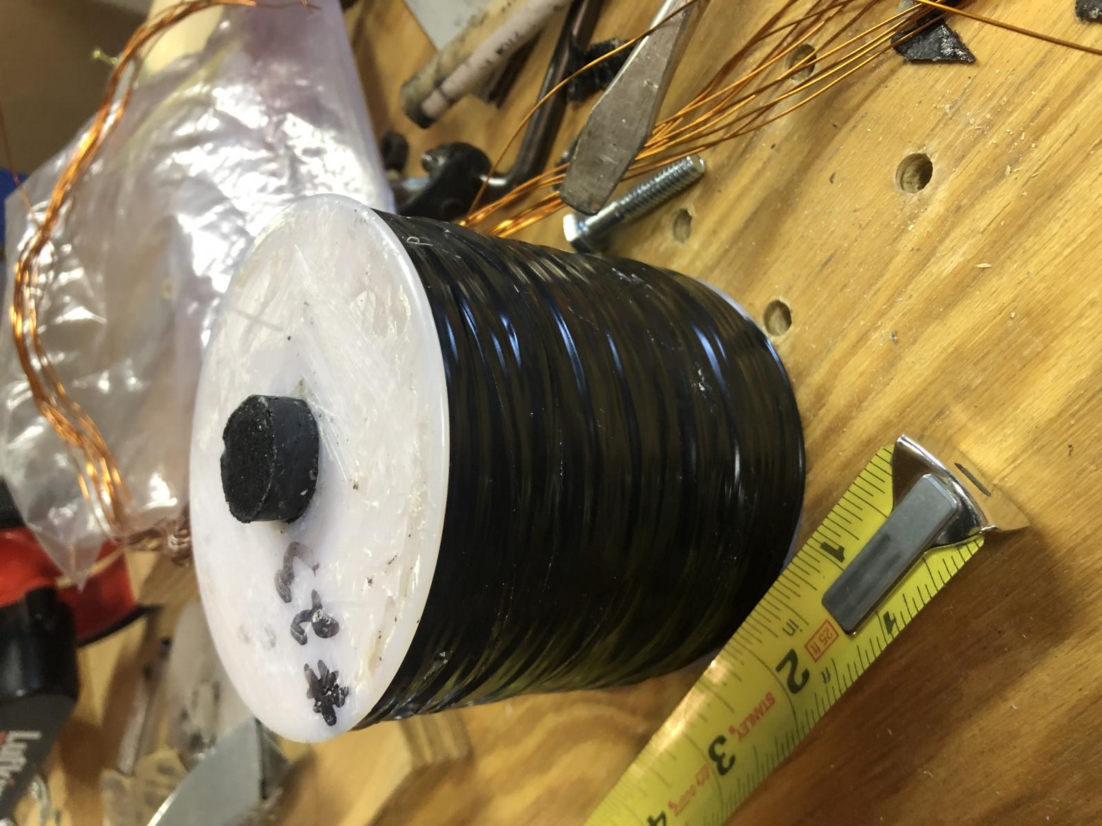

                  • Progress
                    I got a second coil wound today, but I can’t find the filters to filter the ferrite. I only had enough filtered ferrite Matt sent me to do one coil. Got a couple bags of ferrite, just not filtered. You need a 200 micron and a 400 micron filter. You want stuff for your core between 200 and 400 microns. I also ordered 2 1/16” thick plastic plates so I can epoxy one on each side of the rotor. They will have holes where the magnets go so the magnets don’t stick out. Lots of little things to fix as I put this smaller machine back together, and my machinist is over at the independent labs today, getting some help with the bigger machine. So this won't be a speedy assembly, but it WILL get done.
                    Turns out that with 6 north magnets and six south magnets on the rotor you multiply SIX times the 1100 RPM and divide by 120 to get the Hz. So the big machine is doing about 57 Hz. Since the coil output seems to still be 120 volts, he’s going to try running that AC motor on the coil output and if it works, replace the DC motor. He’s keeping me informed.

                    • Bad math
                      1100 RPM with 6 pole-pairs gives 110 Hz.
                        I got a second coil wound today........
                        Got a couple bags of ferrite, ...
                        the Hz.

                        On the Ferrite. I know you said this before and for some reason all the
                        stuff I order now is nano iron dust like you put in caulk broad paint to
                        make it magnetic also. Point me to a supplier so I can compare dust.
                        I know sizes change everything
