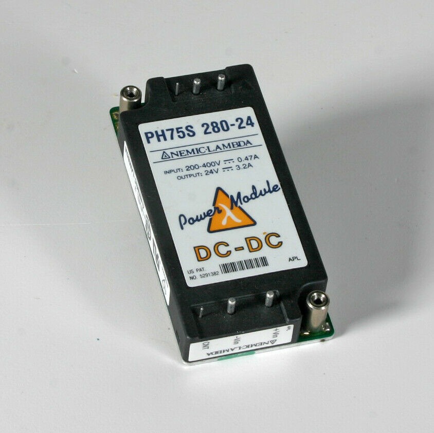

  • Here is an example of a STEP-DOWN Converter. 200-400vdc input ($25) This one may not be your voltage so you may have to do a search to find what you need but they are available.
    https://www.ebay.com/itm/Lambda-Powe...EAAOSwlRVfvTrs

      As to that DC to DC converter... I have written to several companies. The input amperage is always less than 1 amp on the ones I have found. I need at least 1.5 amps, and 2 amps would be better just to be safe. I COULD rewind the coils with one long strand and have an increase in the voltage and a decrease in the amperage, but if I lose Amps on the Conversion to lower voltage DC, it doesn't do me any good. I am NOT going to try to get everything working with this to have a totally functioning machine that is a self runner and all that. If I CAN, and it is relatively simple, I will give it a shot, but my main focus is just to PROVE way more output than input and that "Neutral" coils and magnetic neutralization do what I said they do. I can do that by running it from the wall on a kilowatt meter and lighting up a bunch of 300 watt bulbs where voltage and amperage output can be measured. That's good enough for me. Let an electrical engineer take it from there. I have an old friend who is an electrical engineer and specializes in power systems management. He designed the longest operating DC system in the state of CA. By longest I mean in distance. So he knows a thing or two. a guy like him could solve all these problems in his SLEEP once he sees it running and I can prove the concepts. That's my goal.
