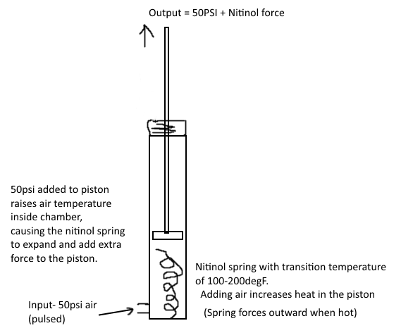

    I've been pondering the possibility of using pressure-based temperature changes (was it called adiabatic heating?) to cause Nitinol transition and harvest the extra force.
    We only need a 30-70degF temperature change, which seems doable with fairly small pressure changes (20-50psi).
    So, on input, we'd have 50psi on a piston, but on output we have 50psi plus the nitinol's spring force.
    Forgive my horrible drawing, but hopefully you all get the concept. It has a ton of potential variations too (like a rotary actuator that is triggered by air but powered by nitinol).
    Anyone else ever attempt this or have any thoughts on it?

        Yep, you gave me that idea   (pressure change resulting in 'free-ish' temperature changes)
        I love the elegance of that setup, I just didn't think it would work as-written. Suppose I'm probably missing something.
        Most nitinol setups need at least 30degF to complete their cycle, which would translate to a good 10-15psi if memory serves correctly.
        This would mean you need a LOT of mass and inertia on that weight to apply enough pressure to each cavity.. Which would mean you would be forced to either:
        1: Use thin nitinol which would probably not generate the 10lbs+ force needed, or
        2: Use thick nitinol which has low conductivity and wouldn't counter-spring fast enough.
        If there was a self-sustaining region it would be razor-thin under that theory.
        So, since full-transition range is out of the question, I assume you mean the device would operate somewhere in the middle of the transition range, right? Like a few degrees?
        I can't find much data on nitinol operating within the fuzzy region; suppose I'll have to do some benchwork and see what kind of force vs temperature curves we get...
        I kinda like a simple piston-type setup just because it's easy to measure inputs/outputs of energy under it and see if the concept can achieve a high enough COP to sustain.
