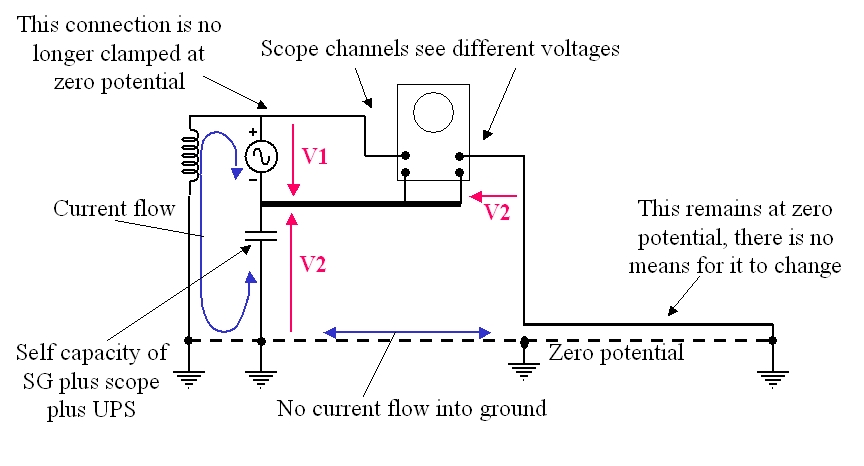

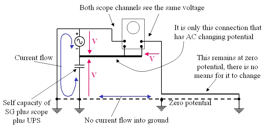

    Dear Ernst.
    Please find attached a possible explanation into the effect I was seeing.
    Quote from user member Smudge at OUR.
    " Here is my take on Grum's experiment. The isolated SG plus scope plus UPS have significant self capacitance to ground, and since the SG connects to ground it is driving current through that capacitance. It is not driving current into the ground rod. Self capacitance is a queer thing, it exists even when the device is far away from the ground that we know as earth. Its "ground" point is really just a zero potential point. The current I show in the first image below is not going into our earth ground, it is just going into space as Maxwell's displacement current to charge and discharge the self capacitance, or put another way to create the alternating electric field emanating from the scope, SG and UPS chassis as their potentials change relative to ground. That first image is for low frequencies where it is clear that both scope channels see the same voltage. The second image includes the inductance of the wire connecting the SG to ground where it becomes clear that the scope channels now see different voltages. The distant earth rod is not responsible for this effect, as would be evident if the second scope channel were connected to the near earth rod.
    Smudge "
    Un quote.
    In their opinion it is simply a HF tank circuit that I was getting close to it's resonant point.
    Kind regards, Grum.

      Let's say it is acting as a resonant tank, why wouldn't there be current in the ground? That earth link between the ground rods and connecting wire forms a pseudo loop... isn't that what tesla was essentially doing?

        That Smudge is a smart fellow!
        I was having difficulty with the assumed ground current between the rods and this is a perfect way around it. Also the phase shift between in and out signal is way too large to be explained by simple travel time.
        This can rather easily be verified.
        - using a longer wire to the far ground pin should lower the resonance frequency
        - putting in a few loops instead of a straight wire would do that too
        - adding capacitance by connecting a large metal object close (but unconnected) to the ground to the combined grounds would also lower the frequency
        A ground current should be able to excite a grounded coil tuned to the sender's frequency.
        I don't think you will manage to do that with such low voltages.
        Maybe it is just still too early (in the morning) for me to try and say something clever but it seems to me that the above explanation can not be applied to the light bulb that you also showed. A full explanation should include that one too.

          Had a few moments to think about it now, and I still think Smudge's explanation is sounding very good.
          Yet in the case of the light bulb, the situation is very similar, but you can not say that there is no current through the ground, for there obviously is. The light would not shine otherwise.
          But it is a matter of quantity. To drive the input of a scope channel to + or - 20V only a minute charge is required. And so a very small current would suffice.
          Still worth a few experiments, I think.
