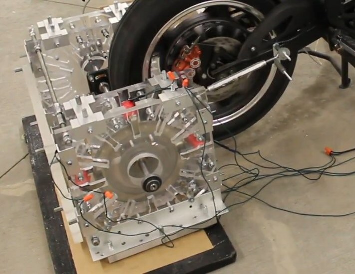

  • 3 C core coils using a 24 pole magnet rotor (or 20 pole) gives unlimited range. The Ebike takes 5 amps at 75vdc to run and the ReGenX generator puts 5.3amps back into the battery.
      Another display of stupidity. From obvious meter readings, battery current does not change signs (- to +) at switching to and from "Regen acceleration" and during test, battery voltage is always below battery open circuit voltage (77Vdc, shown on meter after test shutdown at end of video).

        • It is such a simple idea. The ebike motor out of the factory delivers 5 amps at 75vdc (approx)
          The ReGenX rotor (Approx 14" dia) with 1" magnets (approx 20) at 1/2" thick pressed into holder sleeves which are press fit/ epoxied. Probably sleeves are spot welded to rotor then mic-ed- then pressed . Next is 3 C Core coils that gently assist the back wheel which in turn slightly eases battery consumption while delivering 5.34 amps back to the battery at the said voltage. Unlimited range is so simple.
          If you see what I see then you would know.

            If you listened at one point he says the voltage is also 74vdc which was during normal operation or conventional discharging. So I am not sure why that is a problem. If you have a technical question that I can understand I will do my best to answer it. What is the question?
            Do you know how to use a battery? How to discharge a battery? How to charge a battery?
            How can you charge a battery with a current through the battery which is in the same direction as when it was discharged?
            How can you charge a battery when its terminal voltage is lower than its open circuit voltage?
              I don't have time to skill you in the art so to short form the answer look at an automobile and the way it draws power from the battery and the alternator charges the battery at the same time. Feel free to ask any question but remember that you or I do not know everything. If you stay open something new can enter your thought process.

                Thane is an idiot. If he was right in what he claims and says at the end of that video that the electric scooter can run forever without charging, why doesn't he prove it by just not turning it off. Just leave it run, and run, and run. For hours, days, weeks, and more. He can't because it doesn't remotely function as he claims. He is full of BS.
                You can't charge and discharge a battery simultaneously. And you can't charge a battery at lower potential than it is at open circuit.
