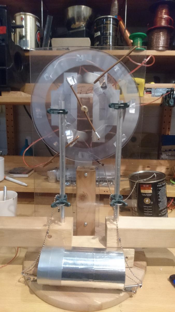

                        Need some help
                        I can not seem to get the inside Voss generator to work.
                        I use poly carbonate plates. Anyone familiar if that would be a problem?
                        I've seen most reports using PVC plates.
                        Or should that be equal ?
                        Or any other suggestions?
                        Anyone know if a comb or brushes would make a fundamental difference ?

                        • #57
                          Not happy, Voss heft left the building.
                          Not happy this time. Can not get figured out why the Voss generator does not work. It is independently running on the inside. But somehow, it does not work and i tried a dozen different tweaks and adjustments. Any suggestions?

                          • #58
                            your type of disk should not matter as long as it is insulating
                            brushes allow for less friction...
                            and other than that, I have never noticed any change from hard contacts or brushes that are right over the surface.
                            do you have multiple disks ?
                            are they potentially to close and interfering with each other ?
                            did you try giving one of your segments an initial charge to start it ?
                              Thanks for replying.
                              In this setup i have one rotating disc and a solid backplate. ( Like a Voss generator )
                              It could be interference, i'm thinking of driving the setup with a motor and disable the electrostatic drive to isolate the Voss and see if that would generate some.
                              I did try to give it a starting charge, but that did not work as well.
