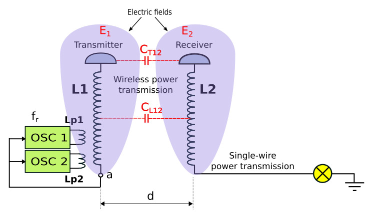

Hi, I'm interested in wireless power transmission using Tesla coils.This is a near-field region.
I think a good understanding of the phenomenon in the near-field region is very important for further understanding of Tesla's work.
For the future experiments, I used a very simple oscillator with a Tesla coil (Slayer Exciter).
With this configuration and with a relatively small Tesla coil, I have achieved very interesting results
- wireless power transmission 60W at 90cm distance or 100W at 70 cm distance.
It is surprising, that the power is transferred mainly by capacitive coupling.
Inductive coupling is in this case negligible.
One part of the mutual capacitance makes top load and the other part is the surface of the coil that operates the same as the capacity.
For longer distances, it is obvious capacitive power transmission more efficient than inductive power transmission.

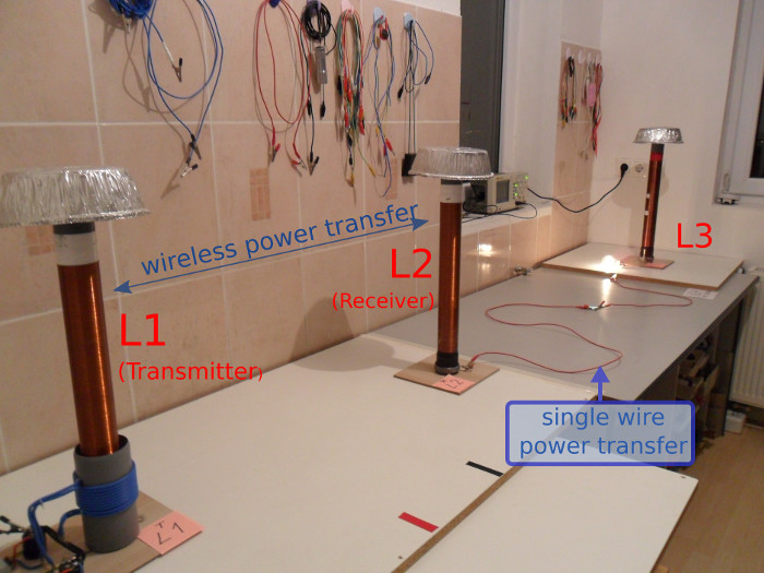

Configuration with two coils and ground connection:

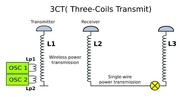

Configuration with three coils without ground connection:

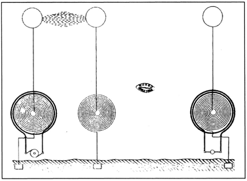

It is interesting that this configuration is somewhat similar to Tesla’s version of wireless energy transmission shown in this picture:
