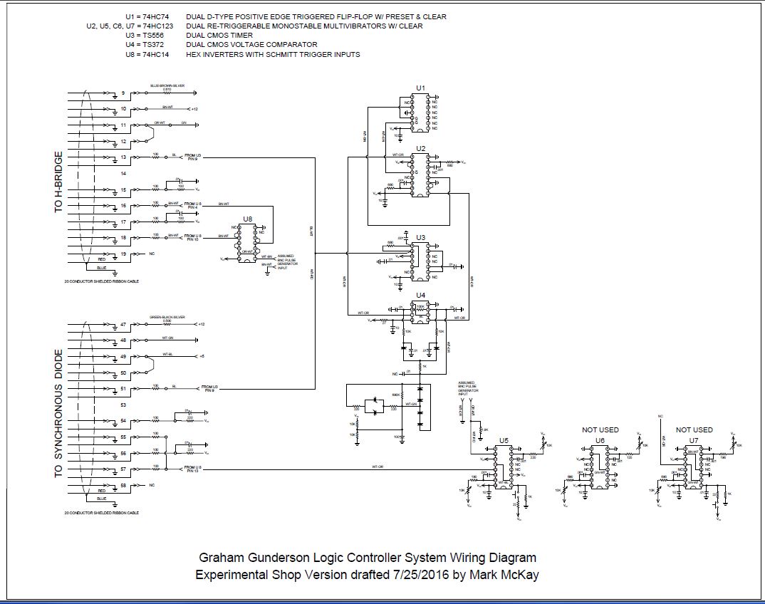

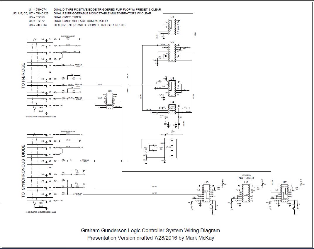

Gunderson Logic Wiring Diagrams

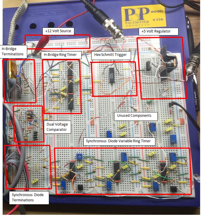

Dear Builders and Measurement Specialists,
Here is my first pass at wiring diagrams for the Graham Gunderson Logic controller. There are two versions. One is the way things appeared to be wired during the presentation. The other is the way the system was connected a week after the convention in Graham's shop. In that version he has disabled some of the chips and appears to have attached one or two pulse generators to possibly sweep input signals.
There is a fair amount of detail in these drawings. I have included pdf versions so you can study the small text. The resistors came in pretty good, but I couldn't see what the values were for the capacitors or the trim pots.
The next step is to develop a logic diagram so that we can figure out what is happening.
Spokane1

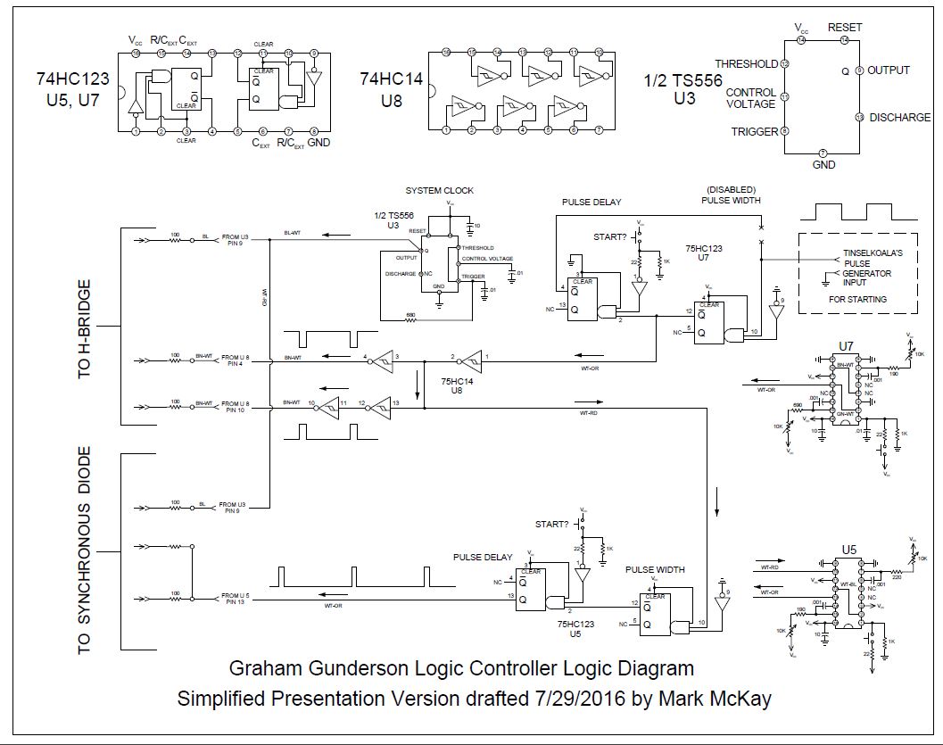

Logic Diagram
Dear Builders,
This is the system logic controller diagram to date.
Enjoy!
Spokane1

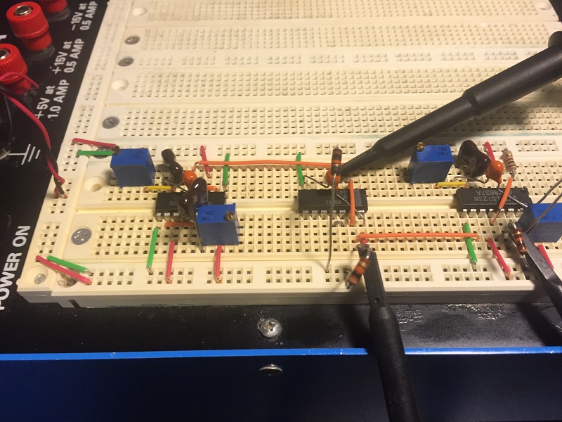

Logic Circuit

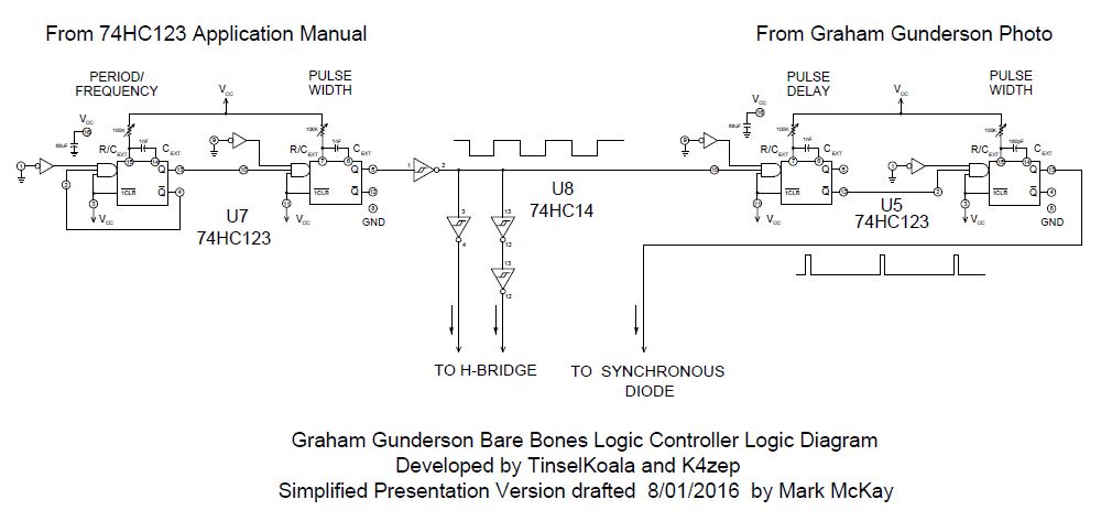

Dear All,
Here is another implementation (Bare Bones) of a Logic controller for the Gunderson Device. This one uses 100K trim pots and 1nF timing capacitors. It also gives a wide range of control over the timing parameters. I used 74LS123 and a 7414 (obsolete). The newer HC CMOS versions should give even better performance and can run at a higher voltage. This arrangement appears to have no starting problems.
What is missing are the trim pot saver resistors (typically 200 Ohm), more bypass capacitors, the push button switches that Graham used (for testing?) and the extra wiring shields around the ends of the IC's (see Graham's photo to see how this was done). I don't know if any of this extra stuff is needed since the fast transition times are controlled by the Power MOSFET drivers.
It appears to me that all of the timing parameters in this sub-circuit are manually controlled. I thought there would be some logic derived control signals, but apparently not.
Many thanks to TinselKoala and k4zep for the development of this circuit.

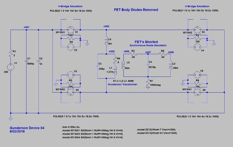

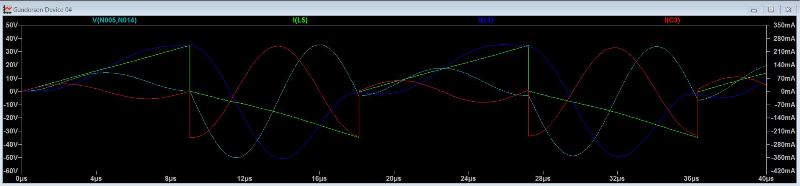

Up next. The development of an LTSpice VII simulation to see how those timing pulses control the H-Bridge to generate that discontinuous 2/3's sine wave excitation input.
Spokane1

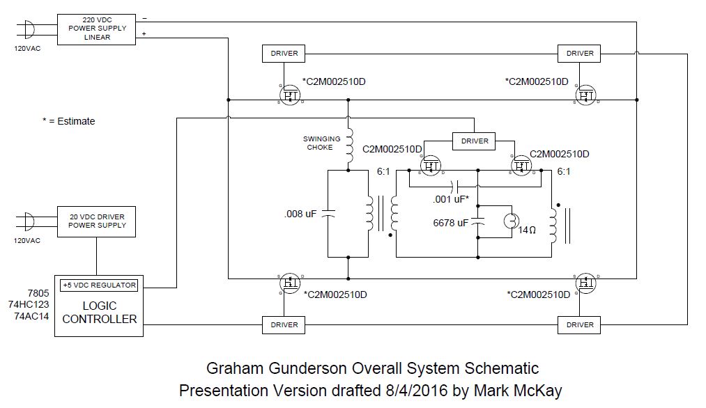

Gunderson System Schematic
Dear All,
Here is a system schematic to date.
Spokane1Attached Files

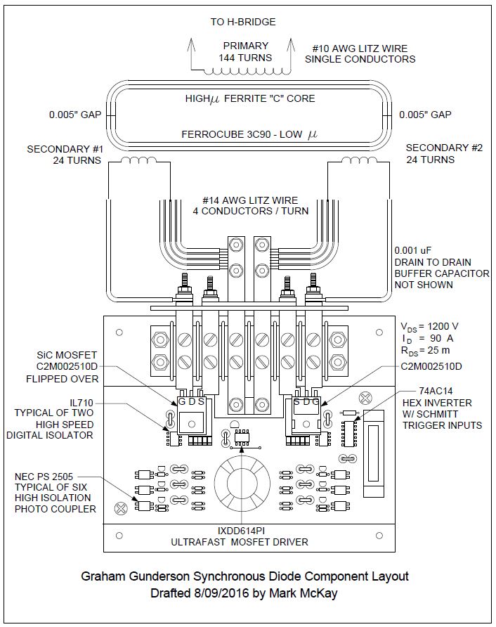

Synchronous Diode Component Layout
Spokane1
Dear All,
Here is a drawing of the Synchronous Diode Component Layout to help facilitate discussions about this sub assembly.
Enjoy!Attached Files
