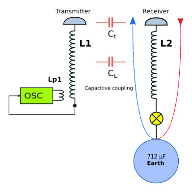

    I was inspired with this Tesla's drawing:

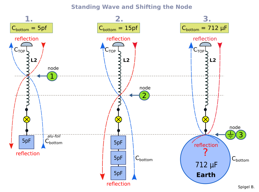

    This drawing shows my three experiments:
    I cannot interpret the third experiment, if I use the same logic as in the previous two experiments.
    How is reflected standing wave at the third experiment?
          Or is reflected on the ground surface, or somewhere inside the earth?

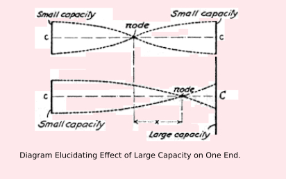

          Perhaps this could be interpreted in the following way - Tesla's drawing:
          It's exactly like Tesla's drawing. The wave is reflected off the boundary of the earth at the opposite side to the transmitter. The activity on the surface is like a shadow. Based on a wave travelling through the centre of the earth at the velocity of light, the average propagation velocity along the surface is Pi/2*c, and everything ends up at the same resonant frequency as given by Tesla.
            In your drawing you seem to forget that as a current flows through the Earth, the Earth also adds some inductance.
            It is just like an ordinary resonating coil; part of it acts as inductance and part as capacitance. There is no sharp line between them, towards the end the current gets less, so also the inductance gets to play a smaller role, while at the same time charges get compressed so capacitance starts to play a larger role.
            I do not remember that drawing of Tesla. Where did you get it from? Looks like a patent application?
            Ernst.
                Regarding the earth inductance and capacity, in any case, it is okay.
                But I'm not sure it gives the answer to these questions:
                Spigel
                  I don't think it is reflected, you'll need significantly more power for that. What you see is a current being sent into and drawn from the earth because of the magnetic effects produced by the primary winding(s). The Earth just acts as a giant reservoir of electrical charge.
                  You are using a transistor driven coil. That is nowhere near the power of a spark gap driver. Power being energy per time unit. you can increase the power by decreasing the switching time. And since there is no semi-conductor that can switch as much current in as short a time, a spark gap will always win (in terms of power).
                  With a spark gap coil and a power input of about 800 W you can (if all is well dimensioned) see streamers that grow in length. I believe that is because of the reflection at the other side of the Earth (which takes 85 ms round trip).
                  Below 800W with the same coils I could not obtain this effect, so I expect that the minimum amount of power to get a reflection is near this 800 W, which is incidently close to the 1 HP that Tesla mentioned.
                  Ernst.
                    Ernst.
                    I think that this explanation is just fine. Only, I do not have a case of inductive coupling than the capacitive coupling between L1 and L2.
                    I am aware that the power of my device is too small to get a feedback signal. In addition, L2 generates a sine wave. It is better as you do, use a short powerful impulse. A short pulse can excite any resonant system that vibrates at its resonant frequency.
                    Thanks and
                    Spigel
