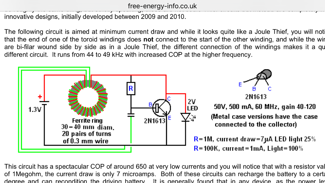

            Have you try this other circuit of Jhonny Aum see in the pjkbook??
            • #21
              Hi wistiti, thanks for the reply.
              Have not tried that particular circuit, though the meissner oscillator variant i built is similar.
              Though will try the one you posted also, though i don't think that circuit is intended for high light output, like the one being tested now is, with the pnp-npn transistor combo.
