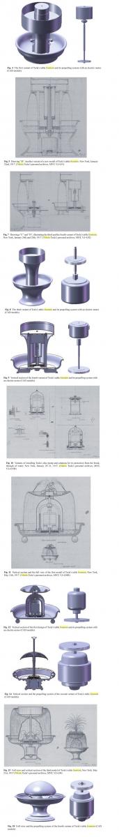

Here is an example of such a fountain, or is appears to be an example of one.
So I built designs in my head for quite awhile and came rough plan for my particular version. But it soon became more that just a water feature fountain.
My design has two stainless steel milk separator cones, upper and lower and the water is pushed in between the gap of the two. The two cones are electrically isolated. It has an RC boat brushless motor, bearings, shaft and prop. It all sits in a large bucket, for continued use.
