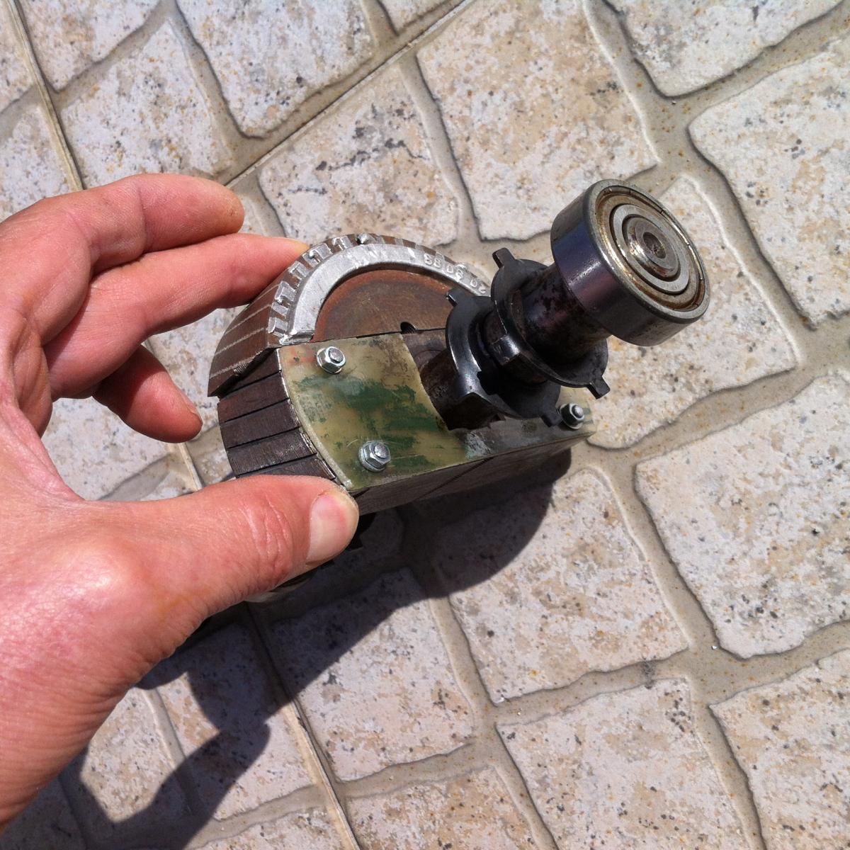

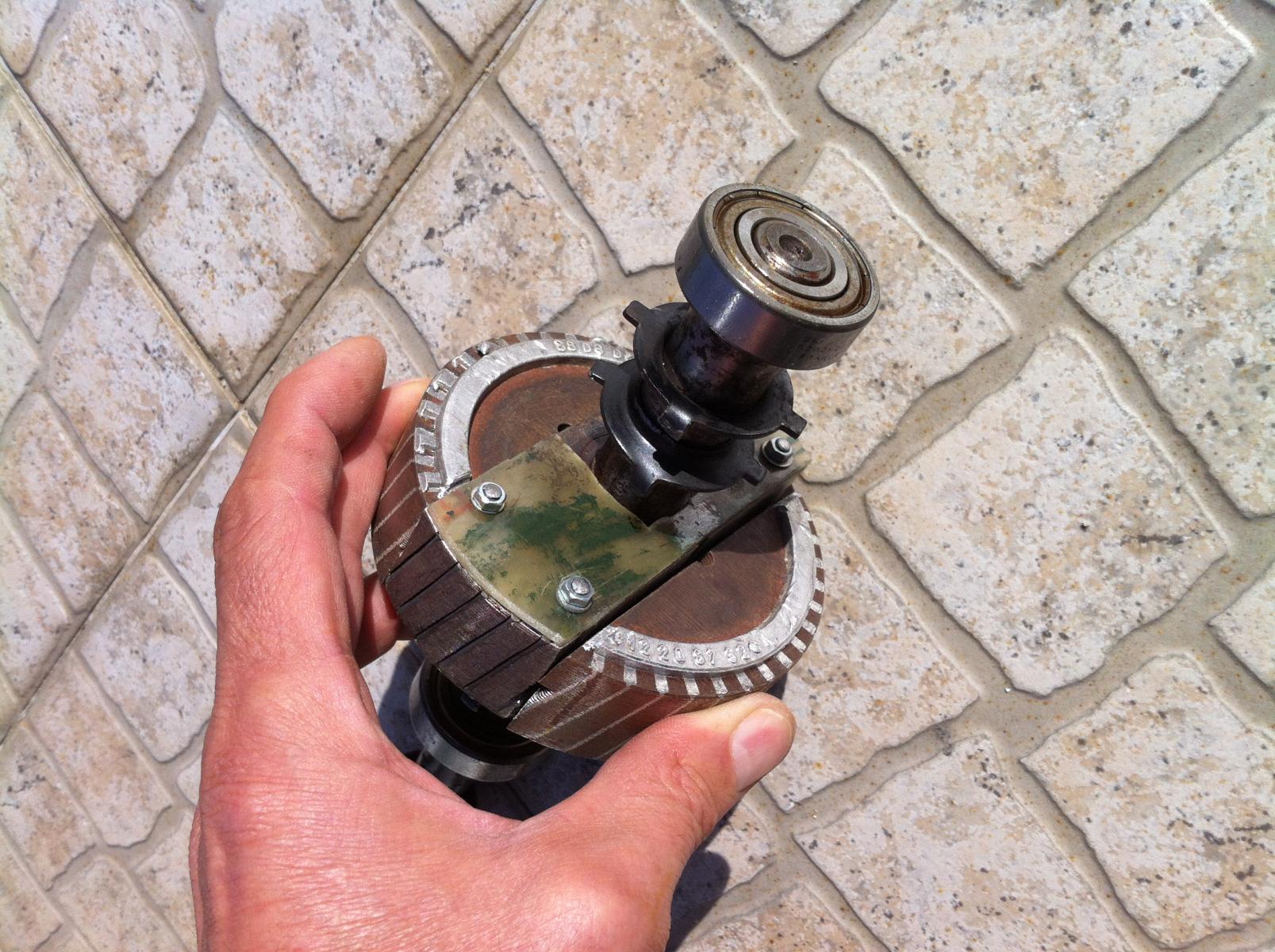

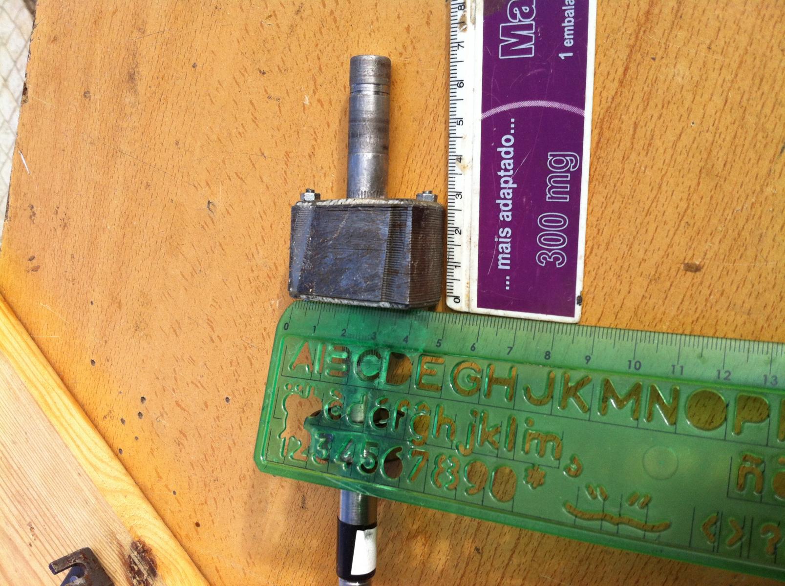

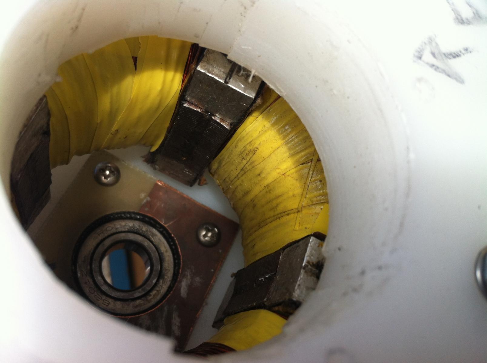

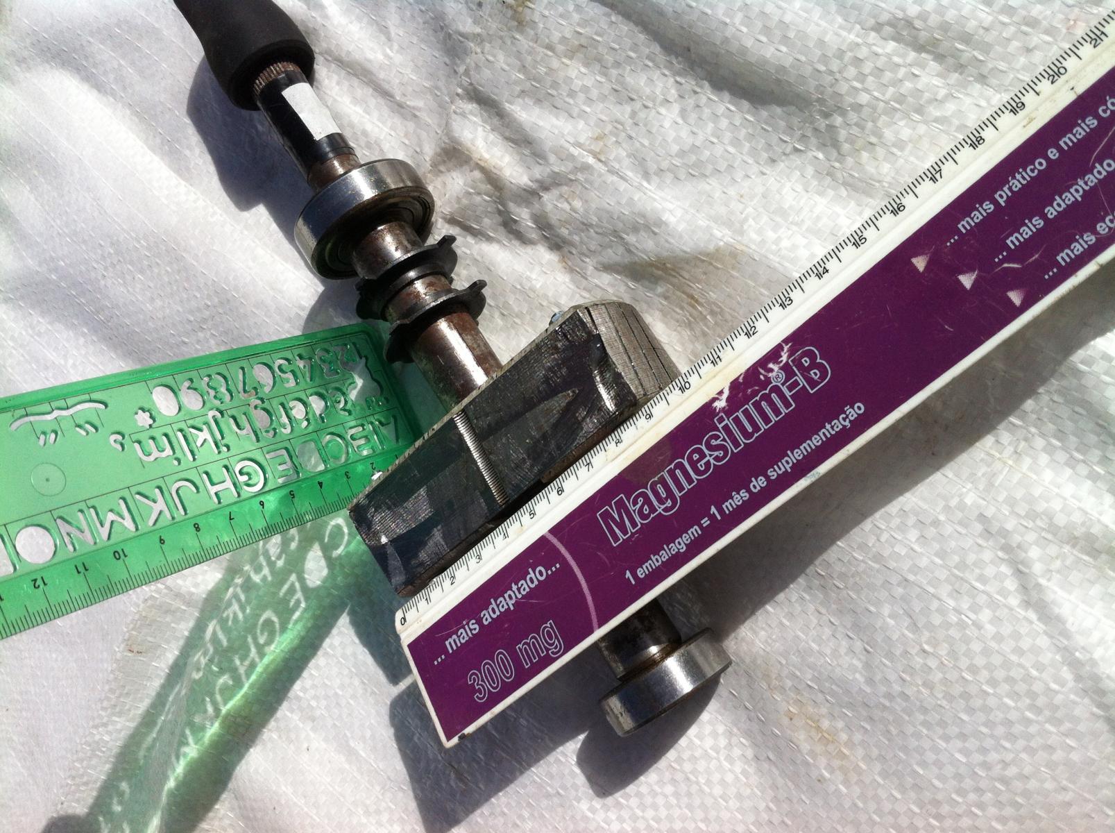

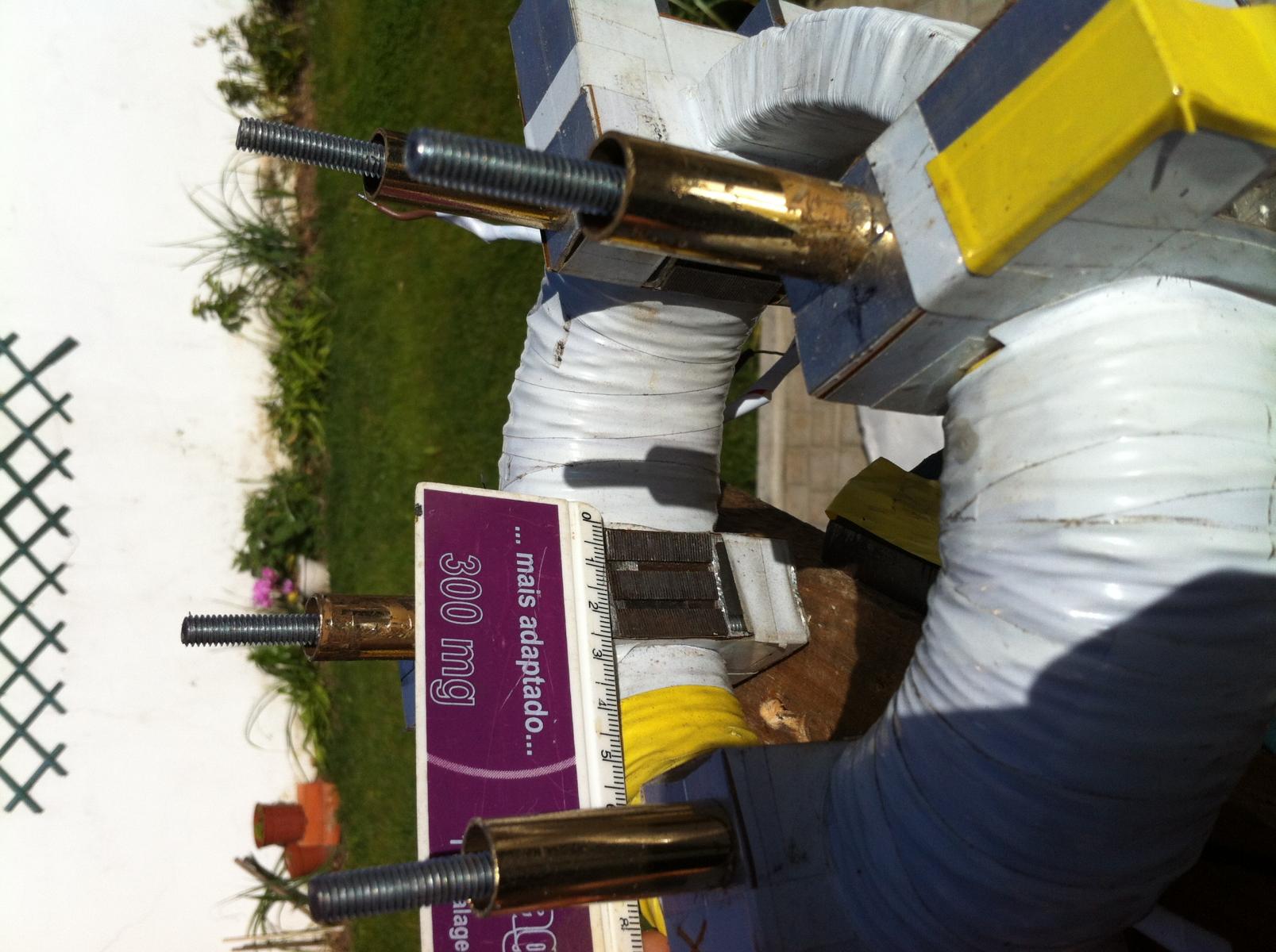

Hi guys!
As I said in my presentation,I will share my work with this type of engines.
It all started when a small tornado contributed to running out of electricity for 5 days ... with electric windows ... hard !!
I started with the bedini engines to charge the batteries .. inverter ..

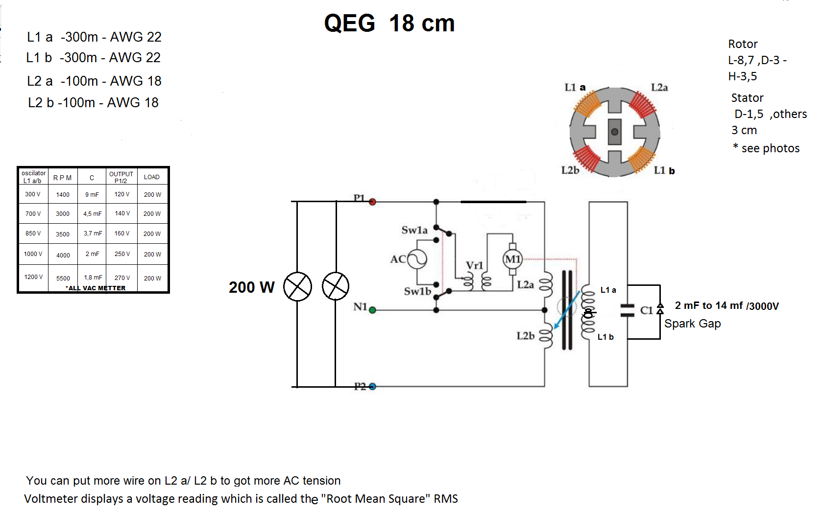

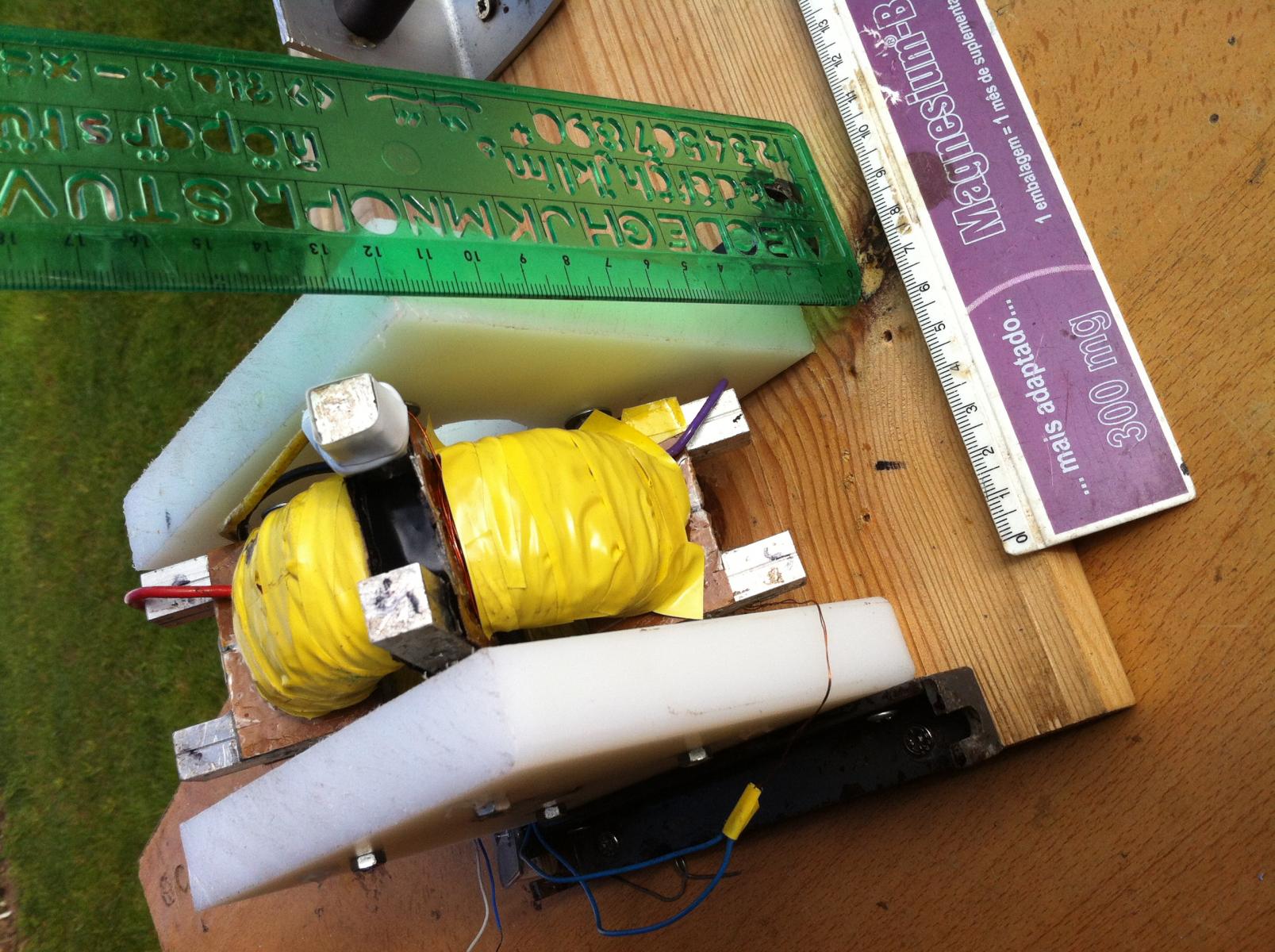

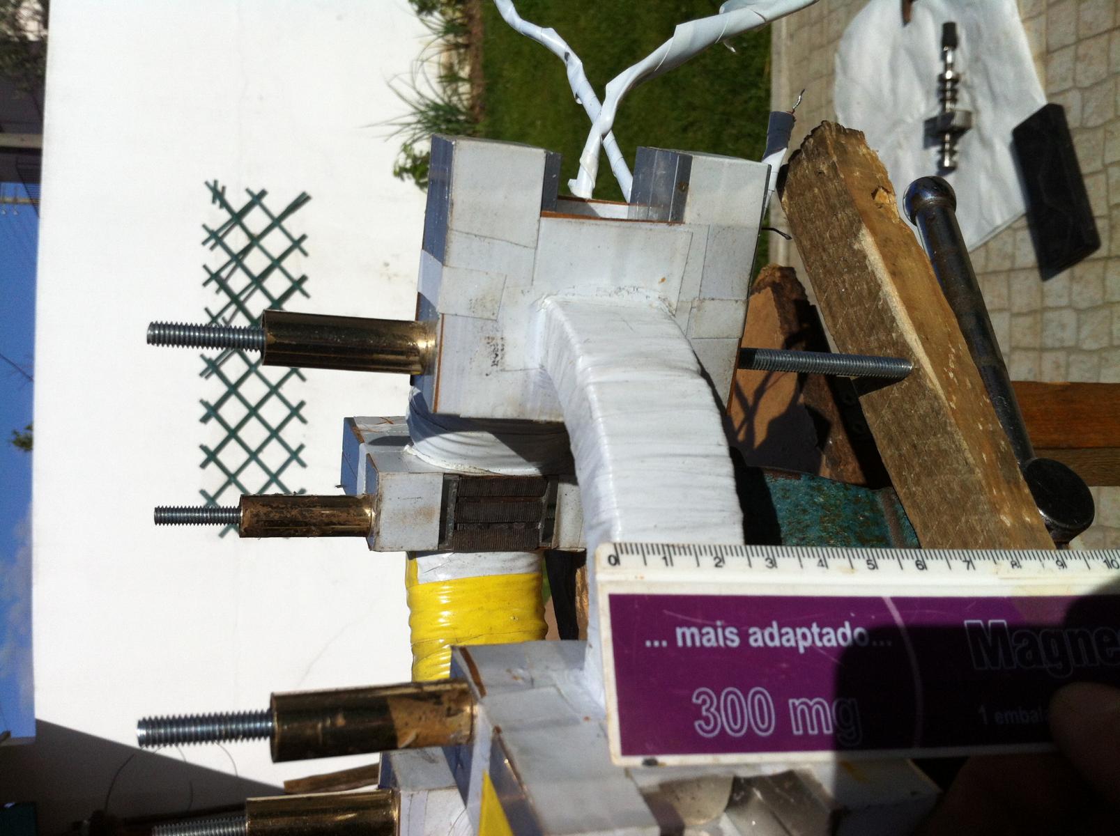

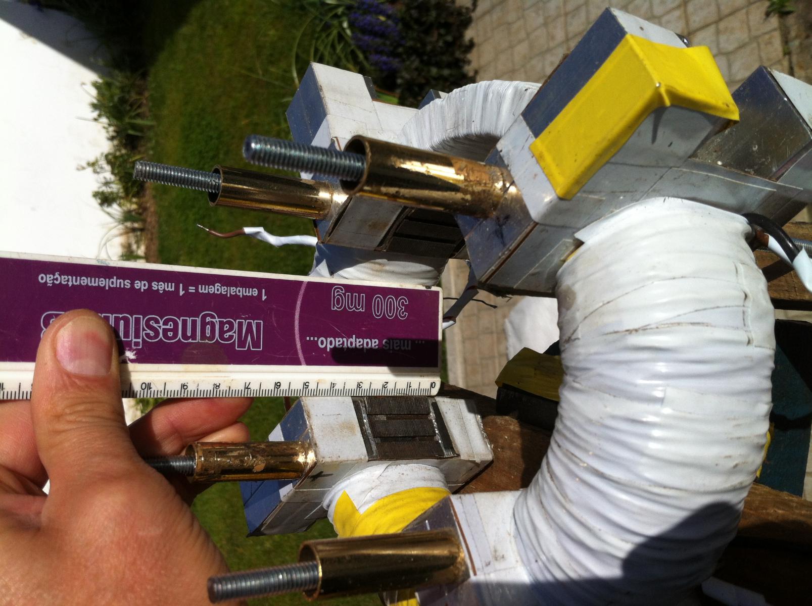

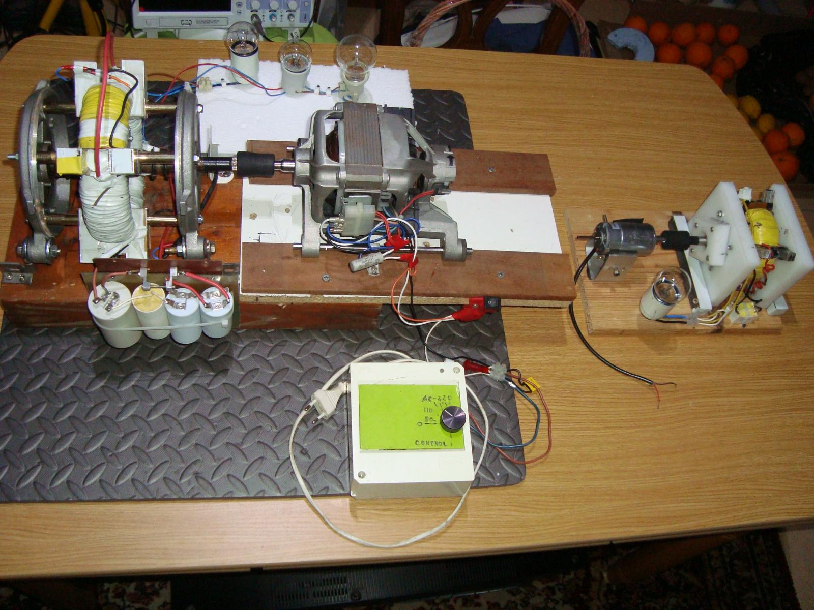

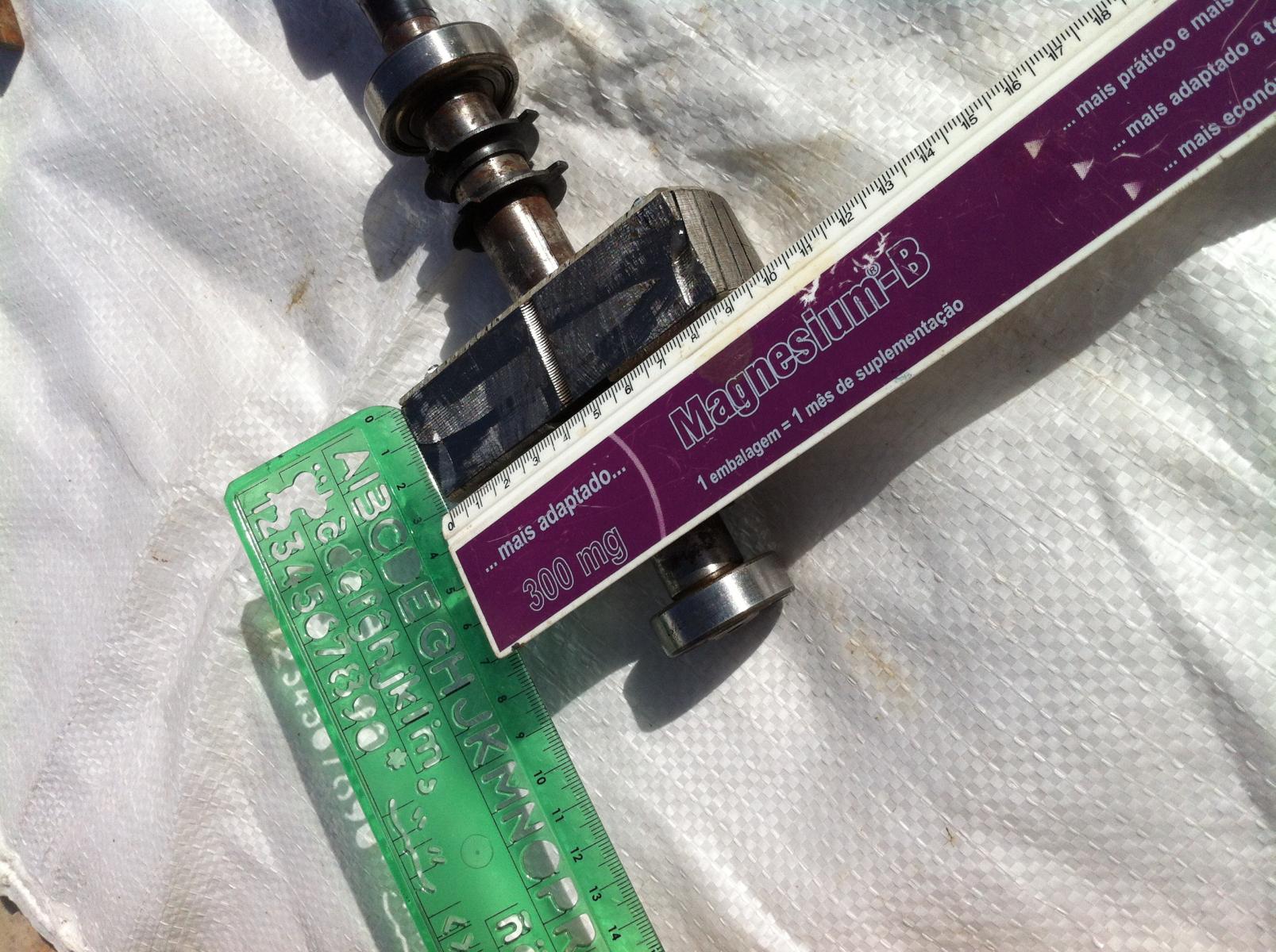

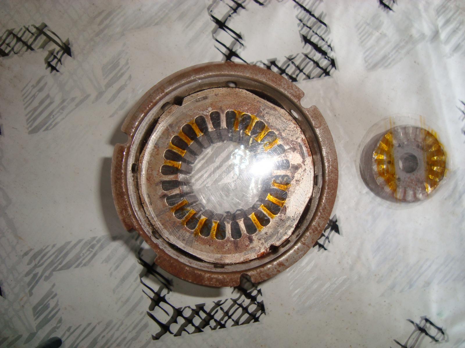

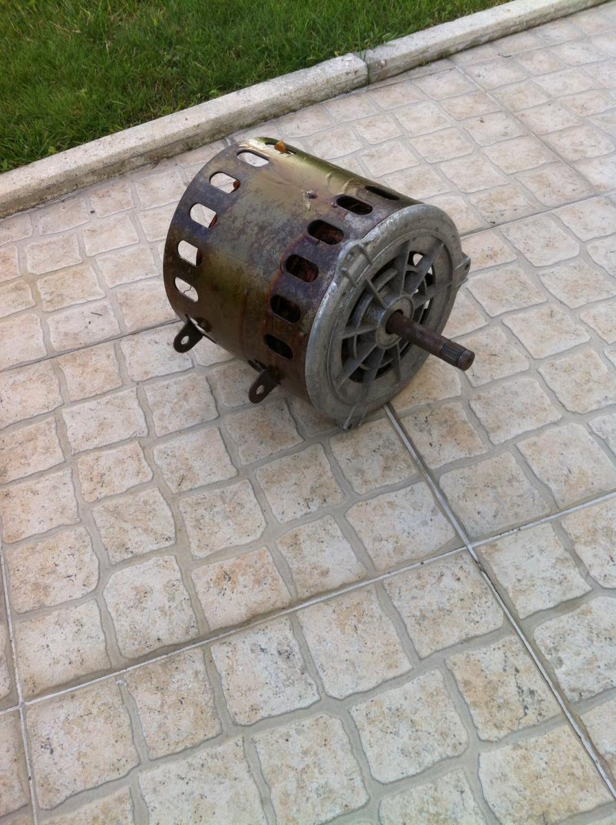

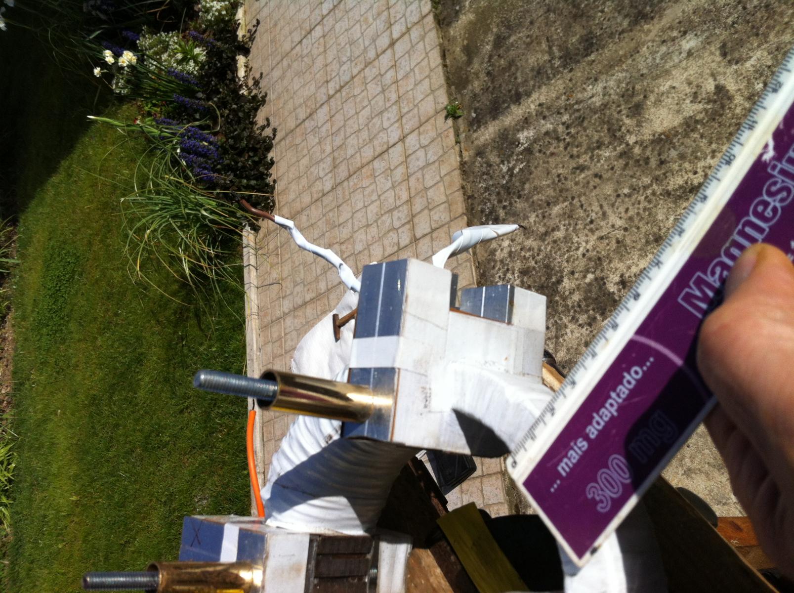

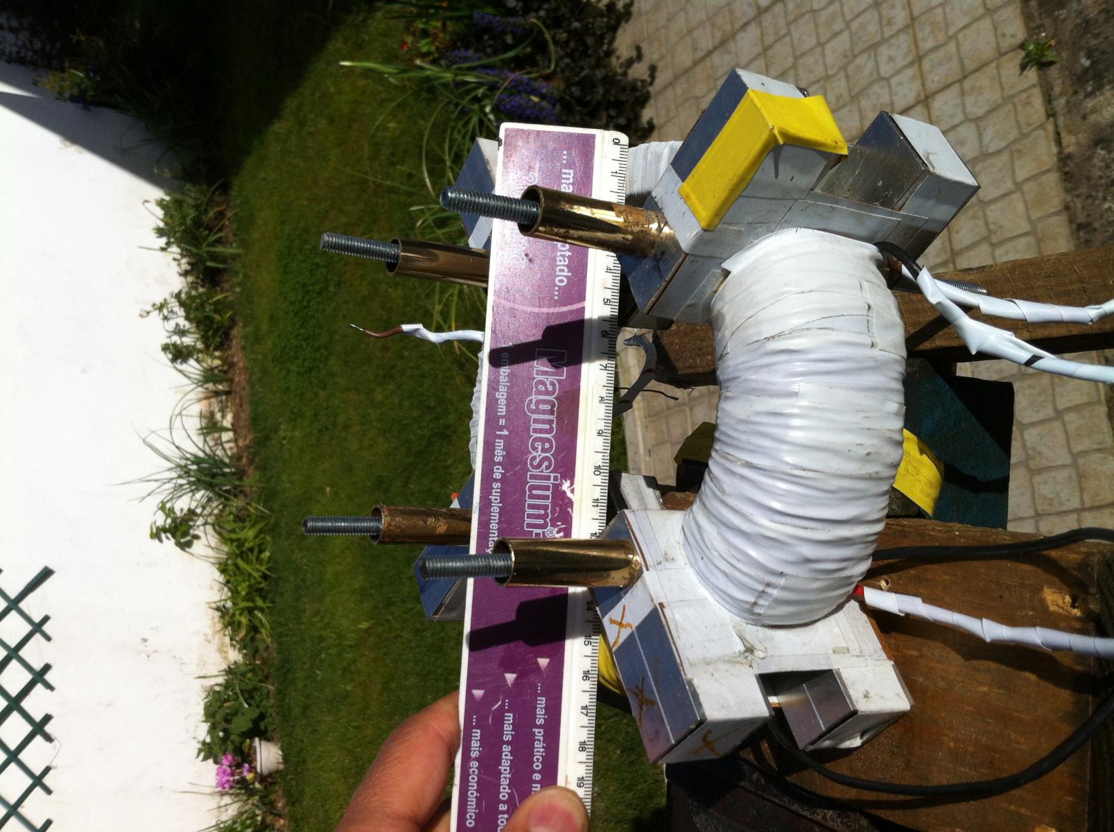

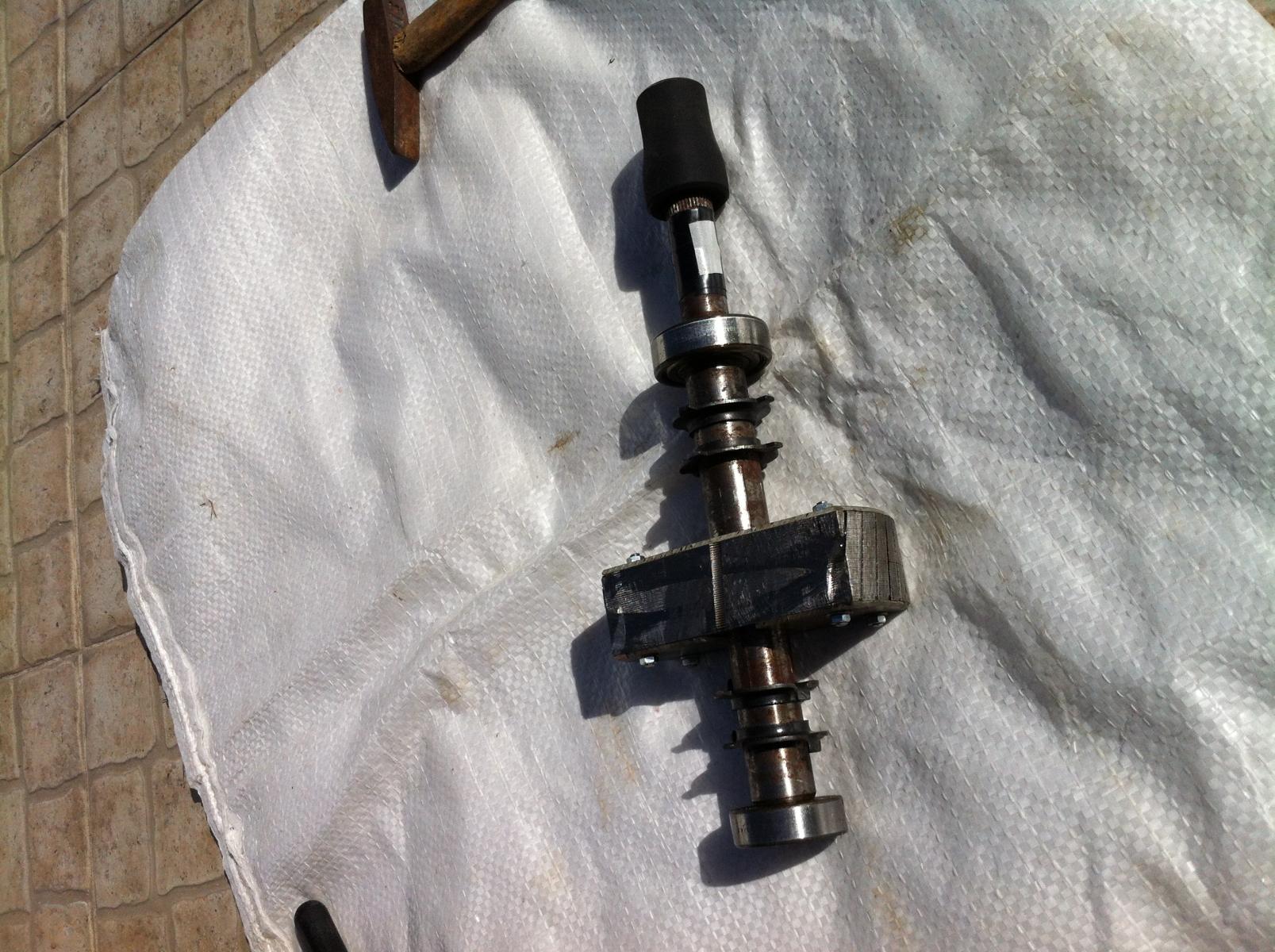

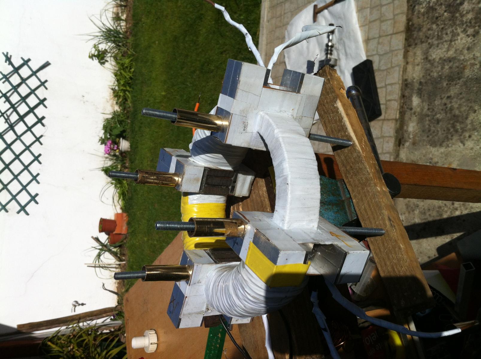

Now I build not one but 2 Tesla motor generator (QEG for some peolple). Small with 9 cm and others with 18 cm.
The small, we call TMG 1, build to prove that there was resonance as Tesla said.
The other,we call it TMG 2 was to achieve my personal goal to charge my batteries.
Here I leave the first photos..
Best regards
Tinoco
