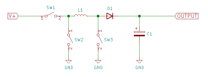

I'd like to copy part of Ufopolitics post here to discuss single one topic :
what is the reason why we can have DC to DC converters or in other words : what is which charges capacitor to the voltage higher then the power source in simple boost converter ?
Charge Phase
A basic boost configuration is depicted in Figure 5. Assuming that the switch has been open for a long time and that the voltage drop across the diode is negative, the voltage across the capacitor is equal to the input voltage. When the switch closes, the input voltage, +VIN, is impressed across the inductor and the diode prevents the capacitor from discharging +VOUT to ground. Because the input voltage is DC, current through the inductor rises linearly with time at a rate proportional to the input voltage divided by the inductance.
Figure 5. Charging phase: when the switch closes, current ramps up through the inductor.
Discharge Phase
Figure 6 shows the discharge phase. When the switch opens again, the inductor current continues to flow into the rectification diode to charge the output.
Charge Phase
Discharge Phase
